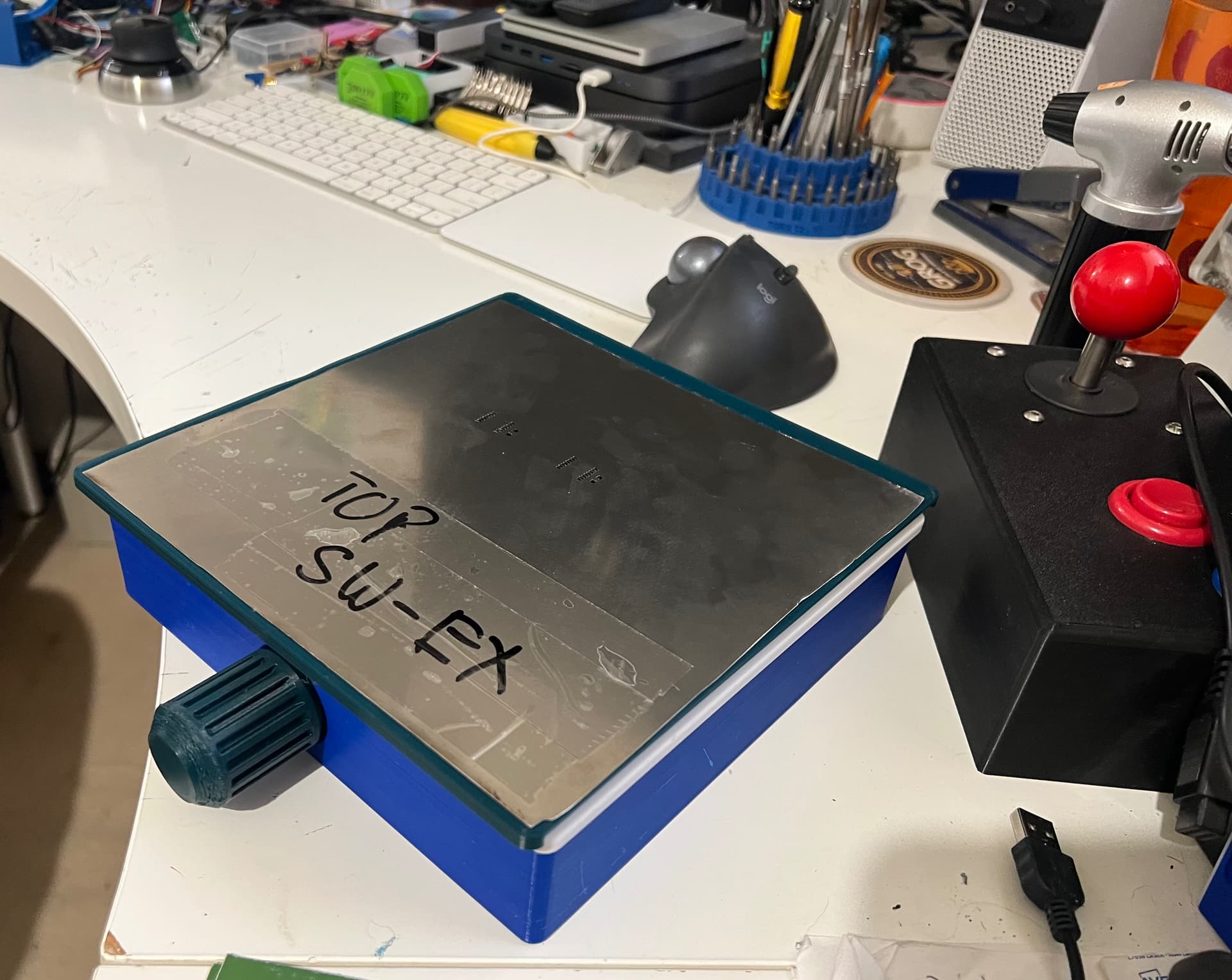

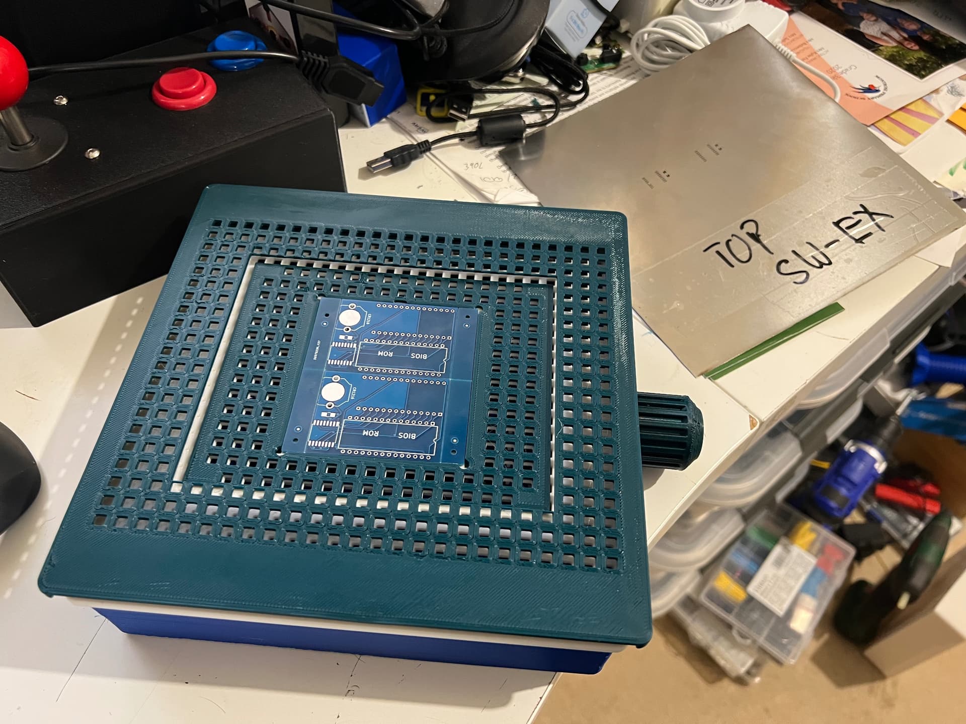

I also built a vacuum operated PCB Solder Stencil jig - the 200x200mm version had a few issues, so I remixed it and printed it out a few days ago.
https://www.printables.com/model/451126-vacuum-pcb-solder-stencil-jig

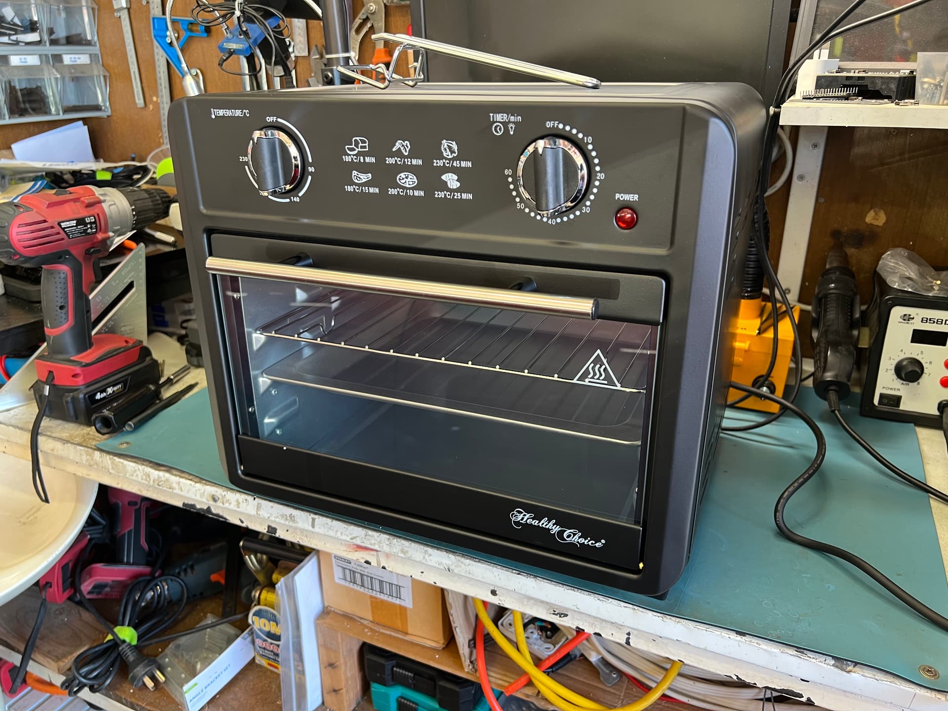

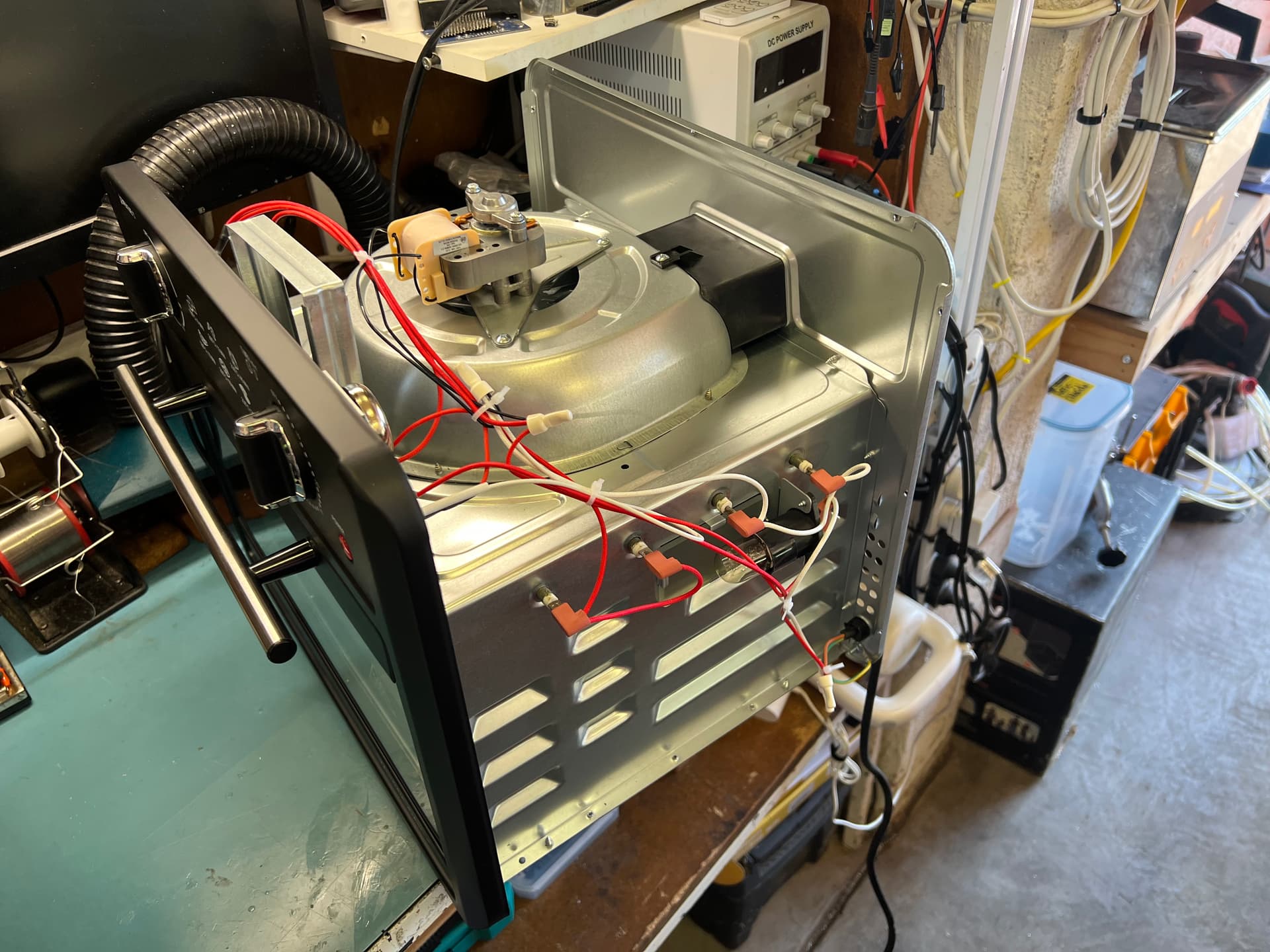

I spent most of today building my new reflow oven, I’m just waiting on a power switch, that’s coming tomorrow.
Before:

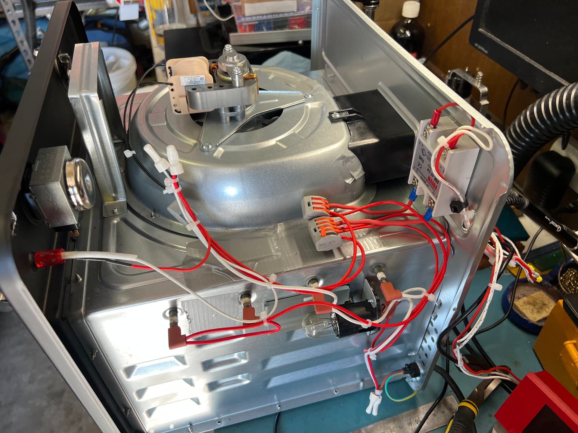

After (minus power switch):
Are you repurposing the original controls for amusement value? From what I can see of the second picture that would be a no... but figured I would ask.
At first I was like "that is an awesome reflow kit" but then I realized you are doing some repurposing.
:slight_smile:
Nope, Aside from adding a power switch to the front panel, the oven is now controlled by a Reflow Master from Unexpected Maker (and an SSR). The OEM controls are not connected at all.
I discovered that the fan duct can be blocked off with duct tape, making it a really nice fan-forced re-flow oven. With the 4 elements (1700 watt) it heats up really quickly too. My old one was only 1000 watts, if that.
