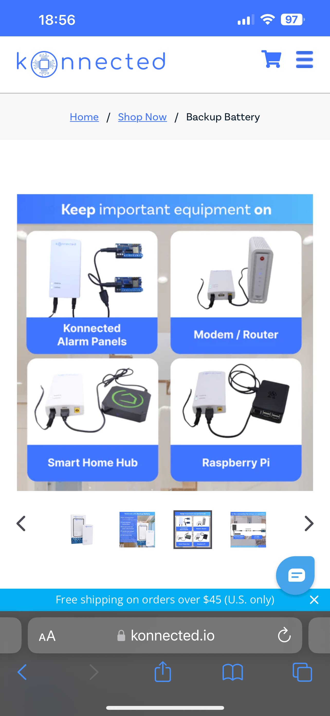

For anyone who wants a prebuilt UPS, konnected sells one today.

I'm helping @dJOS here but personally I'm not clear how to make something that one would want above the Konneted one.

I’m surprised no one commented on Konnected using Hubitat as their example of a smart home hub.
It’s been mentioned plenty of times.
