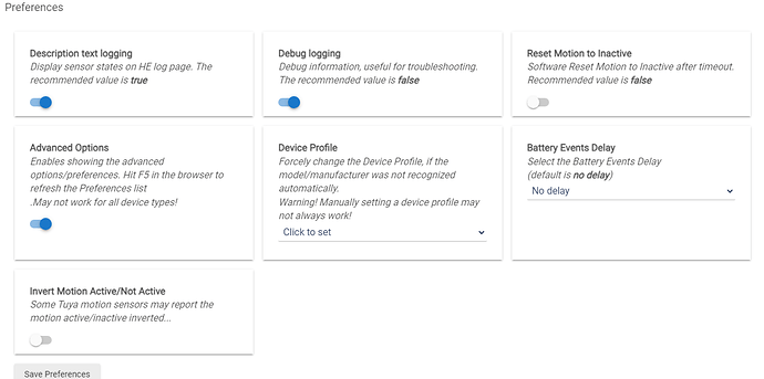

What are the current Preferences (radar settings) values? Make a screenshot of the device web page Preferences section.

You can also experiment with reducing the 'fading time' from 60 seconds to 30 or even 15 seconds. This way the radar should react quicker when there is no movement detected and your tests will be faster..

I just set the sensitivity to 5 and after leaving the room the light went off, great!. It took minute to turn back on.. The room is full with people again so I'll have to wait until later to verify, but I think you hit the nail on the head. Just lowered fade to 10. I'll let you know how it turns out. THANKS MUCH🎆

So sensor is somewhat working "as is" with 4-in-1 driver but no profile assigned.
Here is a Preferences page:
I think some (I hope minor) driver tweak is required.
I will be happy to provide more details and perform more device/driver testing.
Thank you @Dangerous_EE !
I've created a new dedicated thread for this device, we can continue there.
