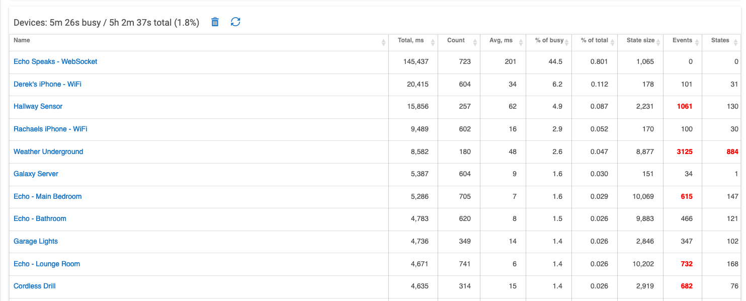

I have 2 C7's and lately, my primary hub has started to get really slow after about a day and a half of uptime - to the point where I've had to schedule a daily reboot or nothing works properly (this at least solves the symptoms).
I just can't figure out why as my hub doesn't seem to be working very hard:
I was hoping there was something I could do - being in IT I like to sort things myself if possible.
