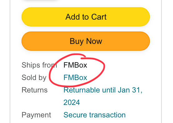

Yeah this is where I get super frustrated with Amazon because even though the top of the page says that you always must pay attention to the seller:
IMG_0473
The latest models will list Amazon as the Ship and Sold by company. Iโ€™ve learned to pay attention to this because some companies will sell on Amazon and not be an authorized dealer for an item and the manufacturer will refuse support and warranty.
