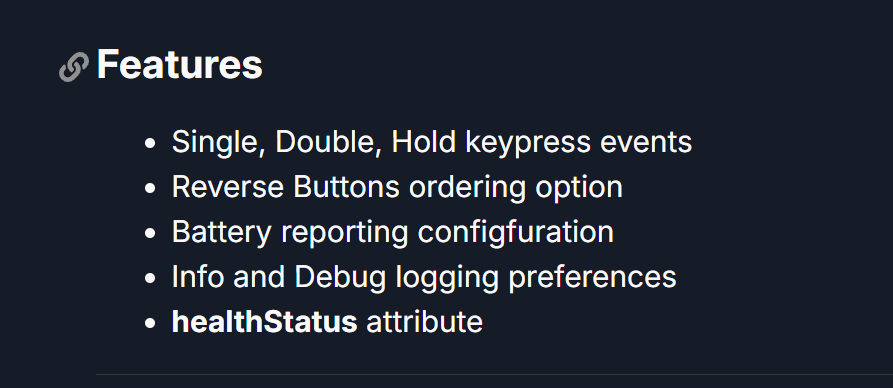

Manufacturer: _TZ3000_wkai4ga5 ←Tuya
Model: TS0044
Links to THIS custom driver that shows a lack of Release attribute:
