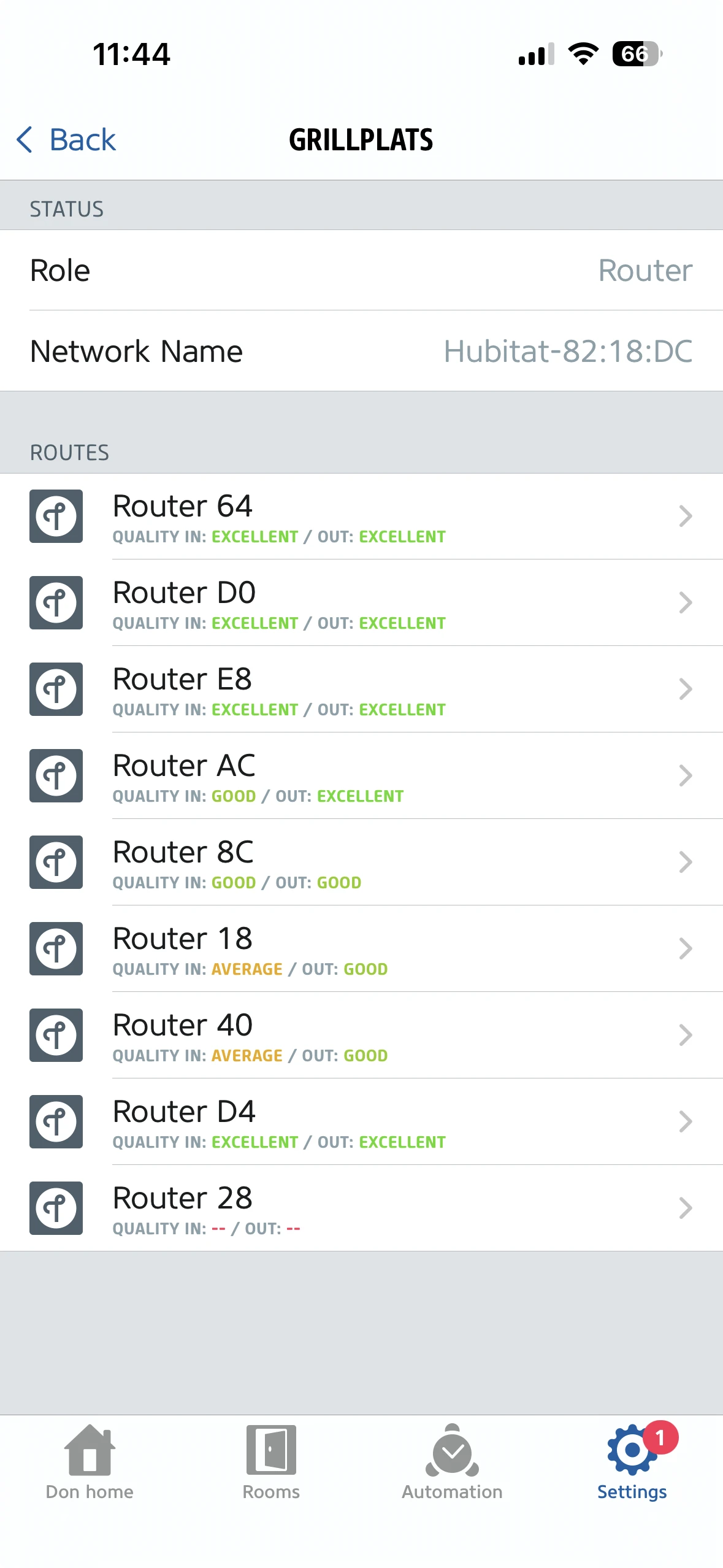

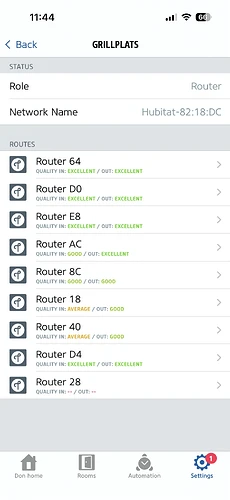

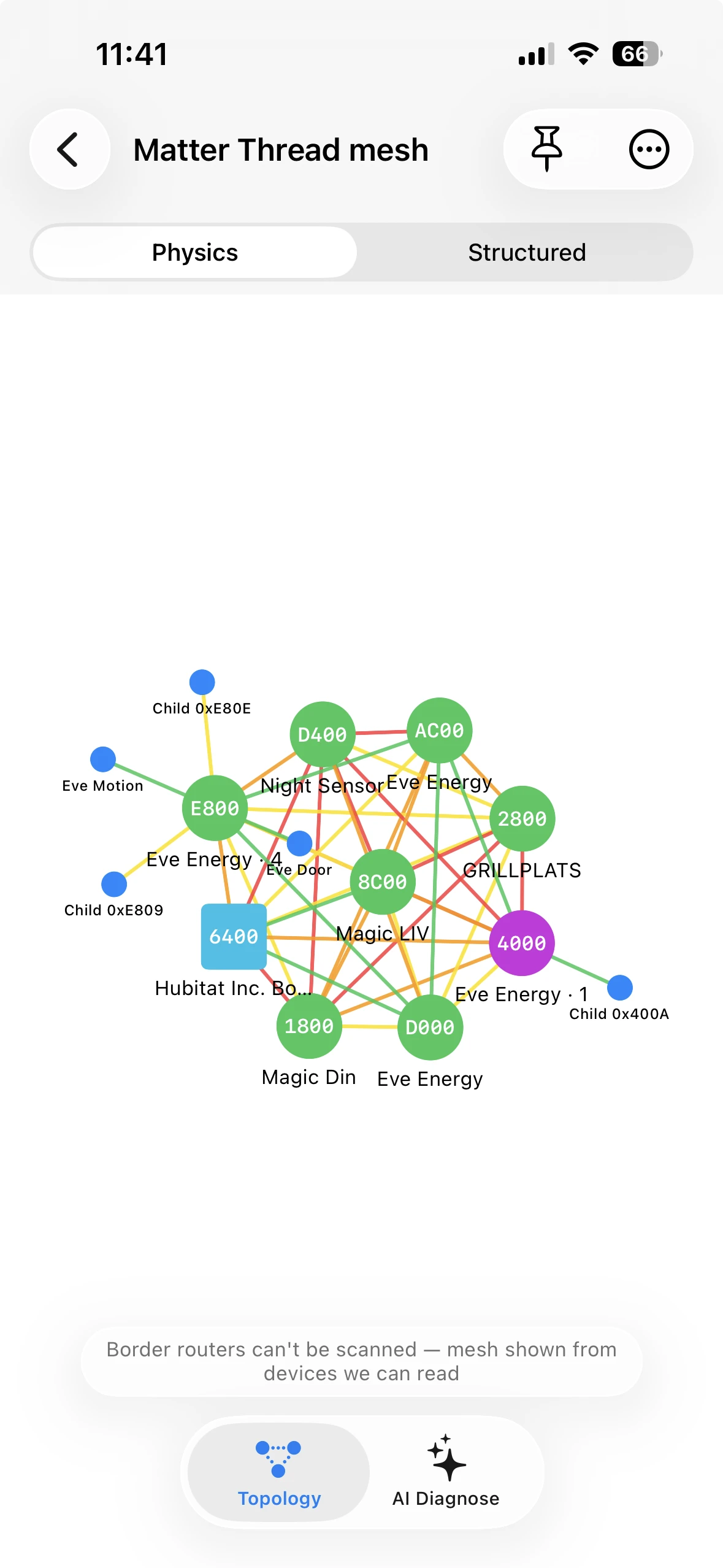

I finally managed to pair the Grillplats with Homekit... which automatically adds the device to the Eve app. I have attached 2 screenshots from Thread Doctor that clearly show the Grillplats using the Hubitat network and acting as a router in the thread network. The Grillplats appears in the upper right side of the Thread Doctor topology diagram.

If you look at the attachments I included in my post 186 you can see that the Grillplats is labeled as a router. The Eve app also calls it a router and so does the Home Mapper app that runs on a Mac. I'm not sure its a very good router. It's a bit slow to respond to on/off commands. But Thread Doctor and Eve both show the Grillplats with multiple connections in my thread network.
