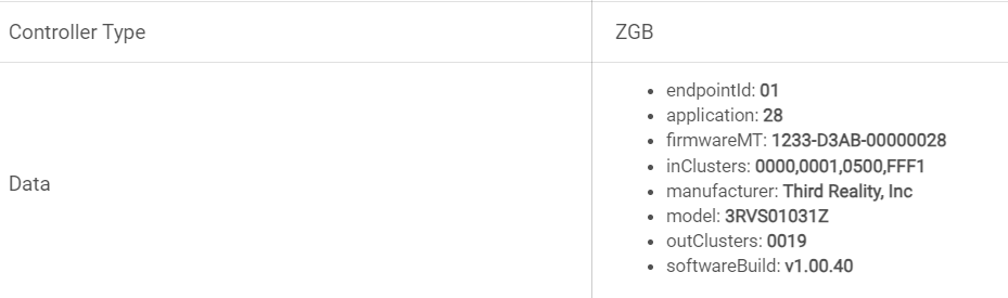

Yesterday, I received my ThirdReality Vibration sensor 3RVS01031Z, and I was trying to understand what the three-axis sensor is and how to use it in Hubitat...
Is anyone actually using the Samsung or CentraLite multipurpose sensor XYZ data in Hubitat?
ThirdReality vibration sensor is now supported in this custom driver ( adds online/offline healthStatus and three-axis readings )
