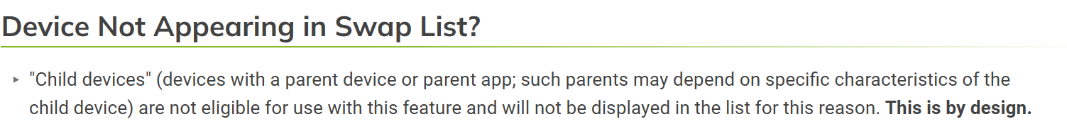

I just tried the device swap to replace the individual plugs in for old plugs.
I am not seeing these plugs as an option for the swap.
Maybe just my old eyes missing something??
Not supported atm.
Thank you for the info.

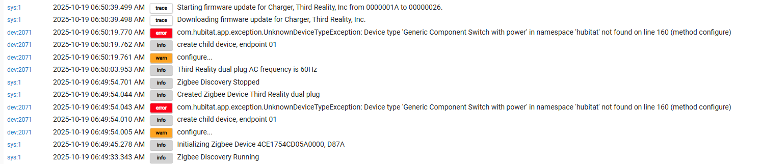

When installing mine I get these errors and no child devices were created and the switch is not usable. Going to update firmware and try again.
It did choose the right driver,

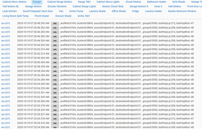

Got it working on the generic multi endpoint driver, but it's sending a frequency report every 2 seconds...that's crazy. Probably gonna pull it, unless that reporting comes down. I recall having some Gen 2 3R single plugs that did something like this, ending up returning them for Gen 1. Shame, pretty usefull plug.
Probably @ThirdReality have joined Tuya and Sonoff in the contest? :smiling_face_with_tear:
Bahahaha, appears so! :rofl:
