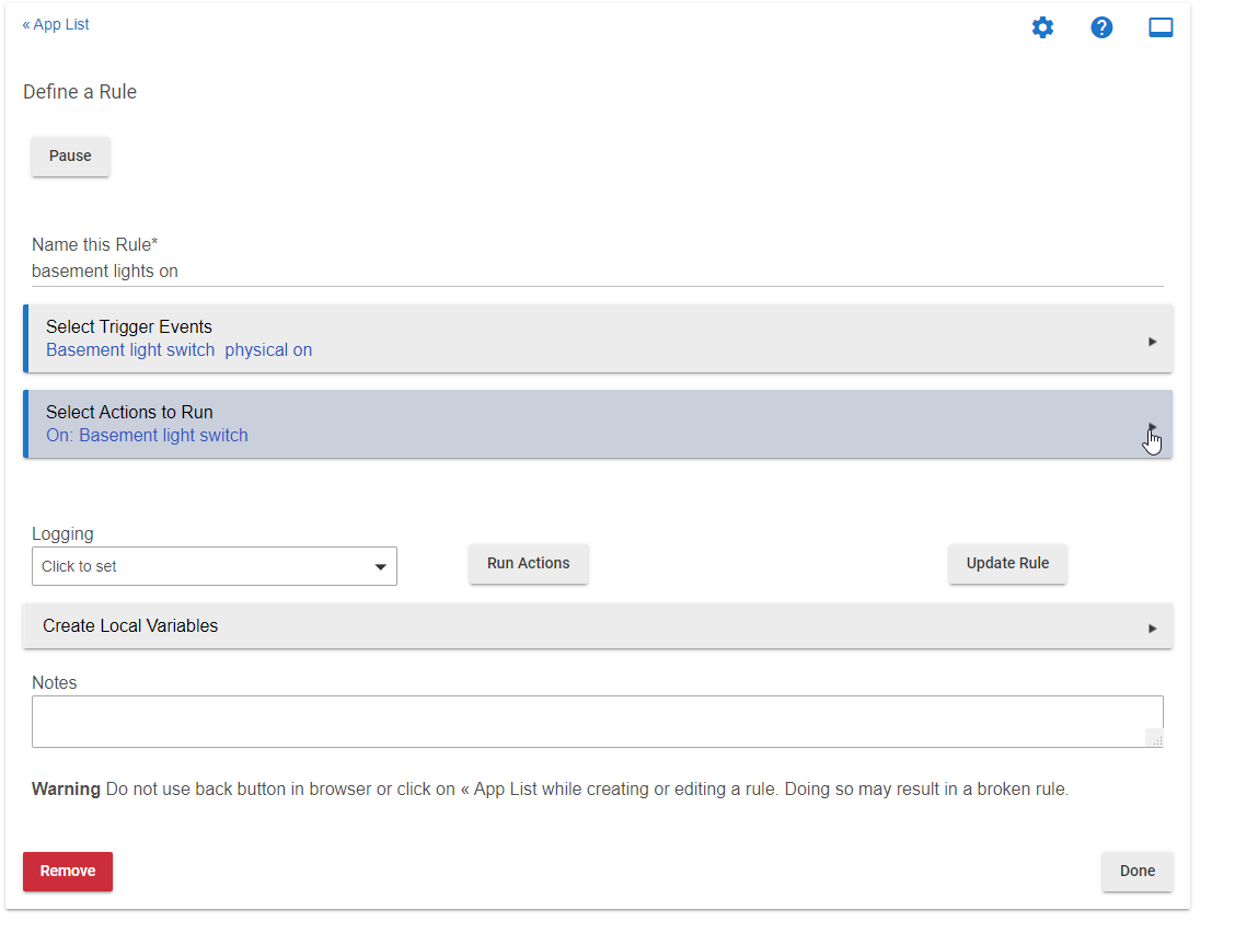

I have tried it in RM by saying to turn the group on or off, each bulb on or off, or the switch on or off. all of these features do the samething if I activate them from the app, none work if done from the switch.

OK, let's take one step back and verify something, please. Can you bring up the device details page for the Light Switch you are trying to use as the trigger for the other bulbs? Watch the 'Switch' status on that page as you manually turn the switch on and off and see whether or not the switch is reporting physical status updates to the Hubitat hub. If the switch status doesn't change from 'off' to 'on' on that page, then the switch cannot be used to trigger those bulbs.
Have you looked at the event in that switch event details to verify that the on/off are populated with a type of "physical"? Not all drivers populate that property, and without it "physical on" will never trigger.

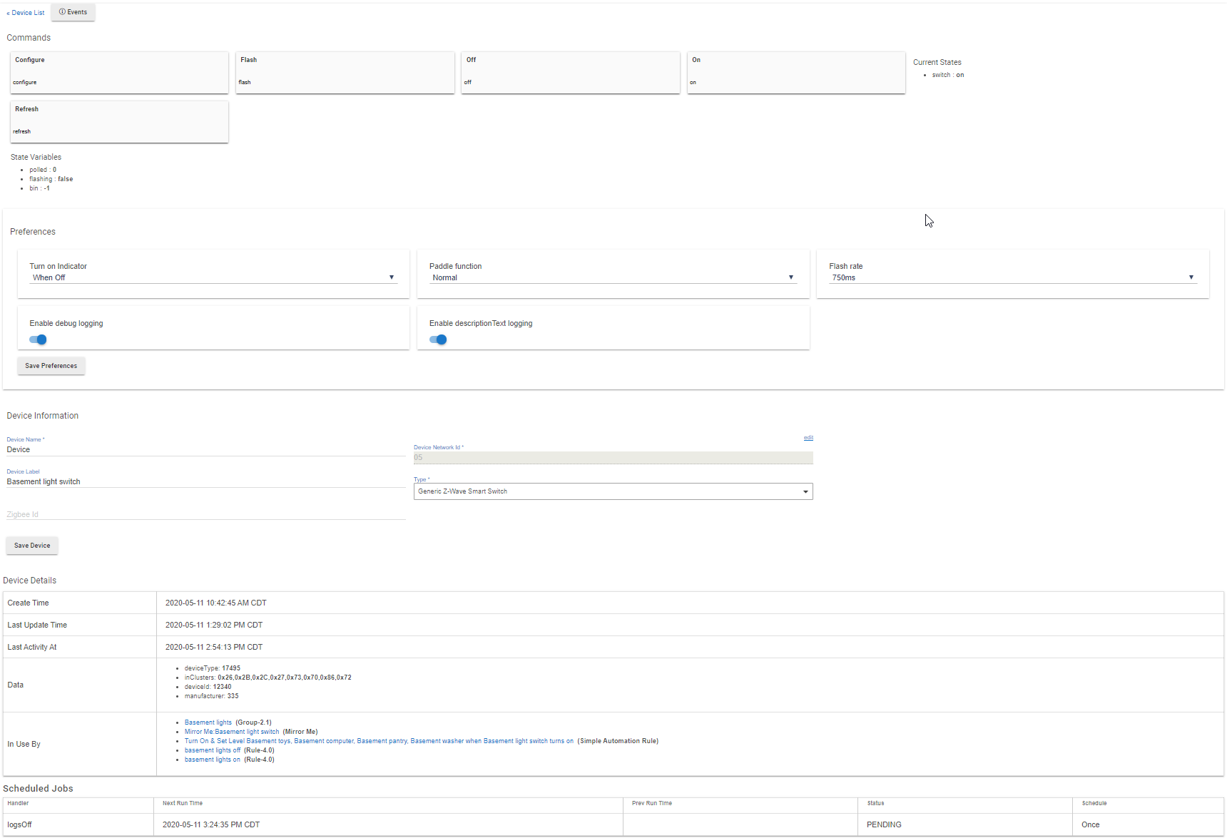

Dang. This is the GoControl switch right? Can you show the device page for that switch (paste a screenshot).
Edit - if it doesn't have Poll as an option on the device page, it won't show up in z-wave poller.
yeah that is the one.
Ahhh - you need to change the driver to "Generic Zwave Switch" and then hit the Configure button on the device page.
That's the wrong driver for that switch.
"Generic Z-Wave Smart Switch" is for z-wave PLUS devices only, and the poller app won't let you poll zwave plus devices. I know... that isn't super obvious...
