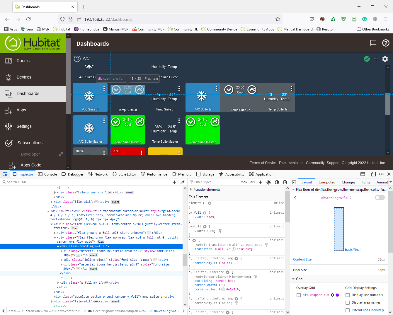

#2, that could be the case. Can you open your dashboard, hit F12, then press the arrow inside the box (right over Page) and hover over the buttons on the thermo tile, actually to the left of the buttons to see what div. is it? make sure the CSS editor is closed before you do this.
#3, hmmmm, appears it only changes when a mode is active. cool is not really a mode, try the color for "idle" cool when it's not active should be idle.
I think it's the operating state it is displaying, rather than the mode. Cooling, heating, idle, etc are the states, whereas cool, heat, off are the modes.
Yes, your exactly right, getting my thermo terminology confused. and color only changes with State right?

So Cool is just a mode. The color of the tile should be the "idle" (provide your thermostat supports the state "idle") color until it starts "cooling", then it will change to what color you have it set for in the editor.
