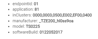

I have the similar on two of mine. The line number may be different due to different driver version.
java.lang.NumberFormatException: null on line 1921 (method parse)
Can you replicate this error? I need to know which driver version you are using.

@iEnam Looks a lot like mine, but yours is 2 minor rev versions higher.
