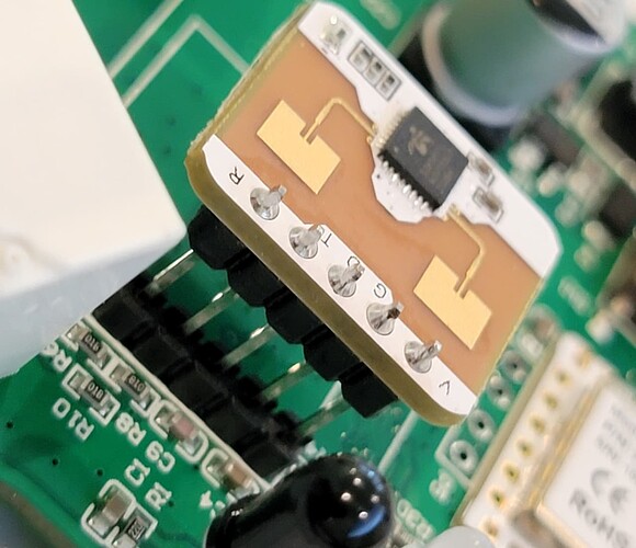

The new Tuya Human Presence Sensors ( TS0225 _TZE200_hl0ss9oa _TZE200_2aaelwxk) have actually 5.8GHz modules inside

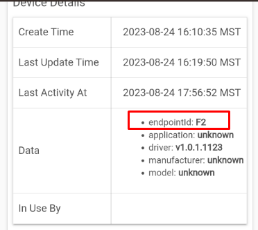

This is the Hubitat platform famous 'F2 bug", mentioned many times in other threads.

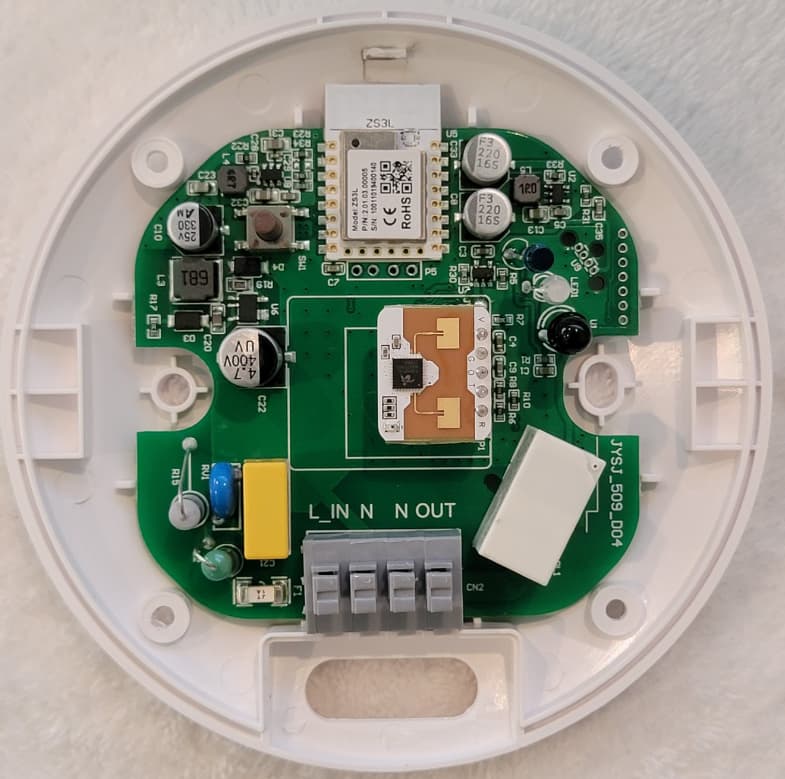

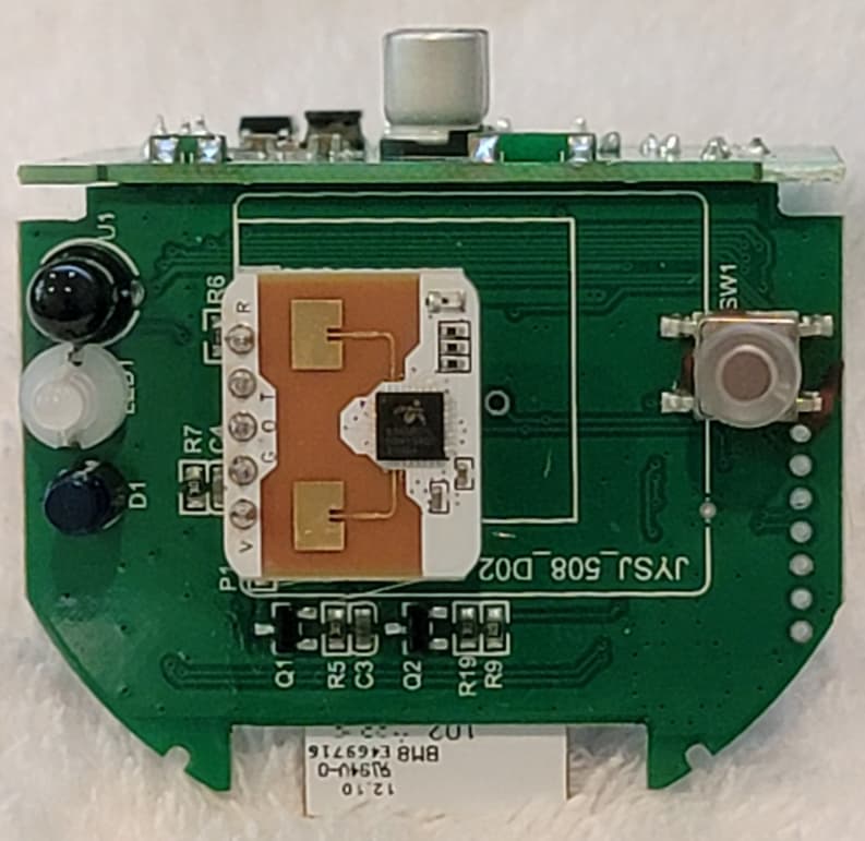

My ceiling mount version arrived as well so I opened it up.
*update this is reporting with this data
  • endpointId: 01
  • application: 46
  • manufacturer: _TZE204_clrdrnya
  • model: TS0601
  • tuyaVersion: 1.0.6
State Variables
  • packetID : 0
  • rxCounter : 5
  • driverVersion : 1.4.5 2023/08/26 1:44 PM
  • txCounter : 0
  • notPresentCounter : 0
  • motionStarted : 1693099496058
Working for me when I click the link in the forum. Maybe you have something blocking?
This is the form factor I am most interested in (rear power connection for ceiling mounting). Very interested to know if it has the ‘non-spammy’ firmware onboard. Have you been able to confirm? If it does I will go ahead and order one.
Not yet. Have to dig out out a box of old extension cords to make a pig tail for testing. Probably tomorrow.

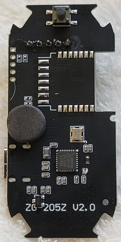

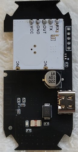

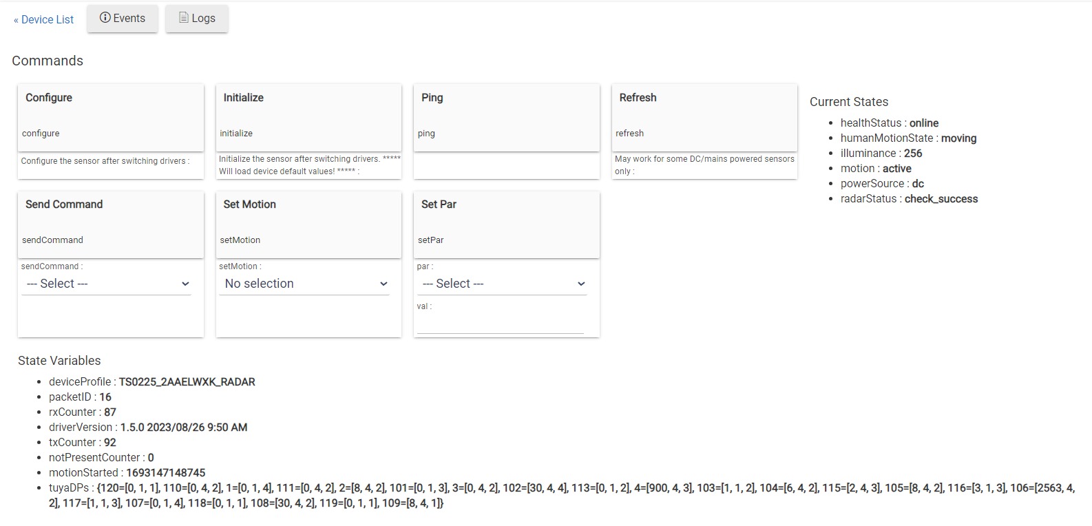

Ok so this one looks like a 5.8g sensor ( _TZE200_2aaelwxk). I was really hoping for the 24g on this one because I really like the form factor on it. They did a great job on the ball pivot and its very small. I also thought it worked pretty well.
@JumpJump thank you for the detailed pictures!
When you pair all of the new toys to HE, please add the Device Details Data sections (as text) to your previous posts, so that we can identify the different models easier.

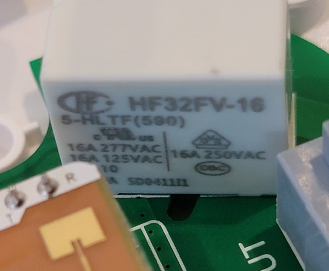

@kkossev I've updated the above posts for the 2 mains units. Neither of them took an update when connected to the Tuya hub. They don't appear to have the same level of detail available as some other devices. Like no breathe setting. They do have the relay on them.

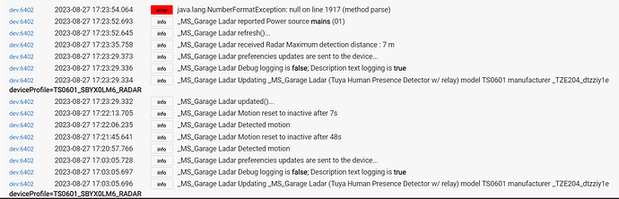

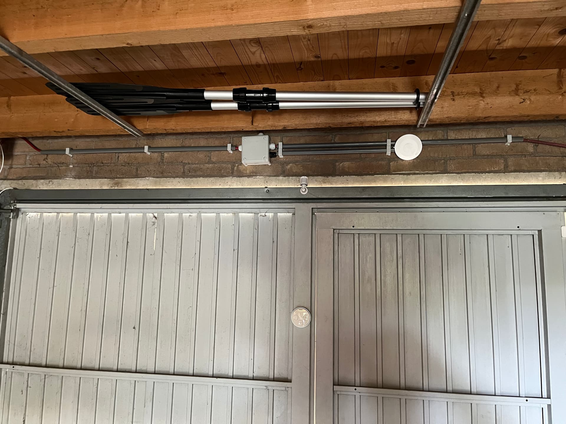

Got the TS0601 and it works like a charm. Only lux seems to be a bit spammy.
Radar fadingtime could only be set with the attribute editor.
But it seems to react fast, and acurate.
Have it inslalled in my garage.
In the logs, it gives a java error:
