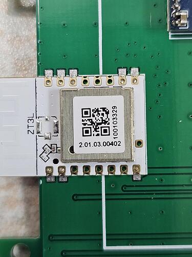

The new Tuya Human Presence Sensors ( TS0225 _TZE200_hl0ss9oa _TZE200_2aaelwxk) have actually 5.8GHz modules inside
That is very usefull information for me. Because I can do hole in wall or ceiling, provide power to that hole, and cover "radar" sensor by drywall. Now only I need to choose correct one and implement it in house.
