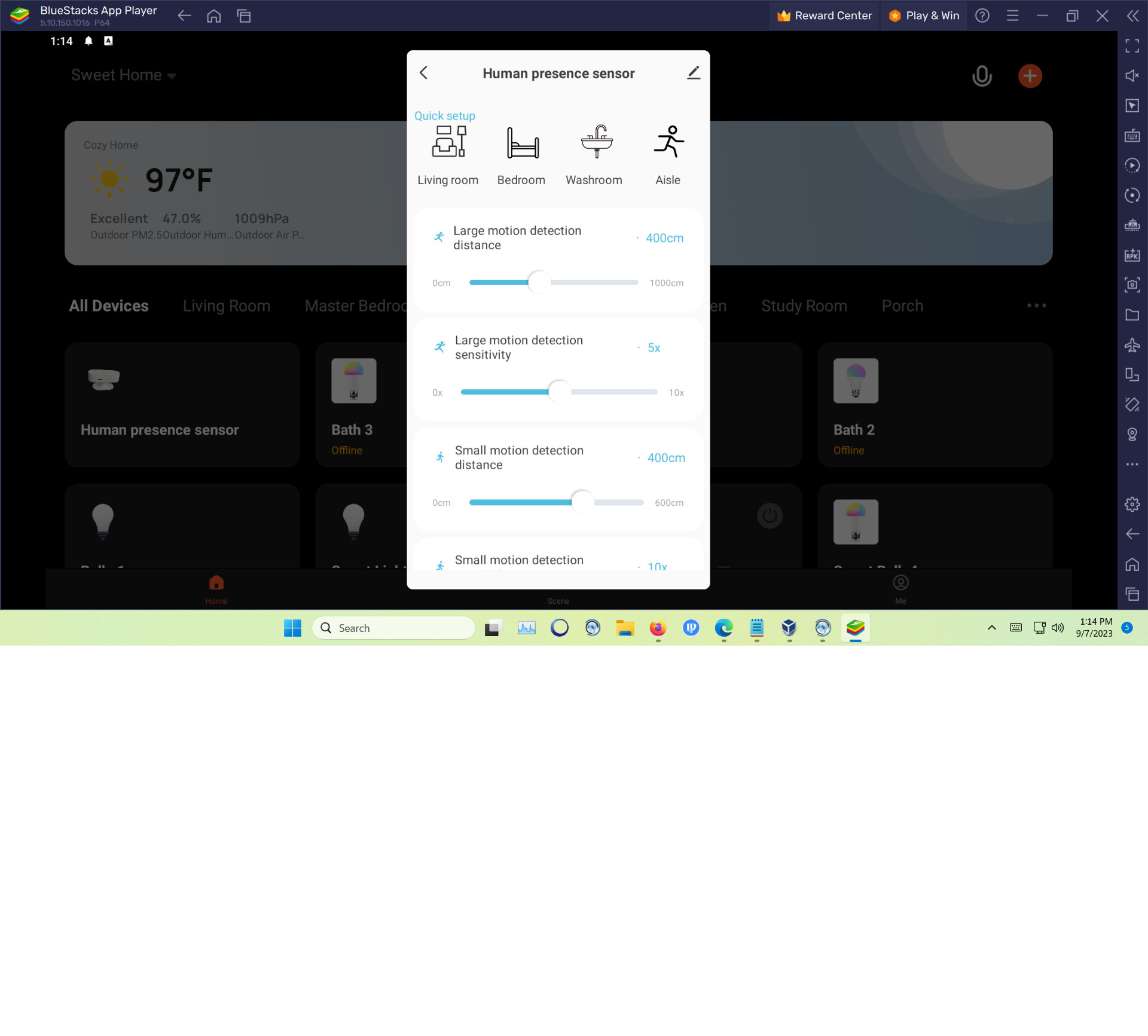

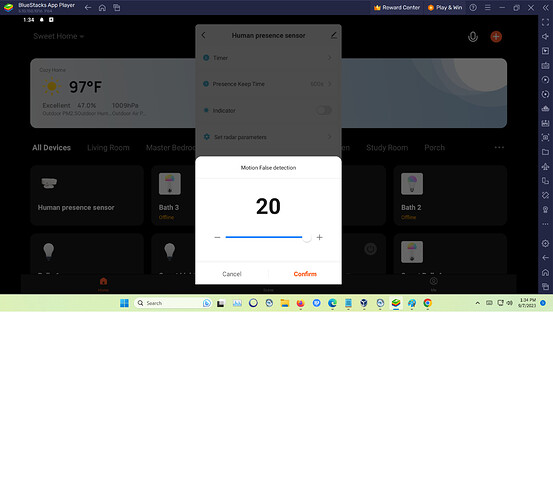

I don't see any settings for minimum distance for macro motion, small, or static detection in my Tuya hub. Just sensitivity and max distance. I guess this model does not have those minimum distance settings at all. I thought the seller listing said it did. Their description was incorrect? Shocker! I wonder what the 24 GHz mini they're sending me will have options-wise. Their description for that one is a mix of several sensors.
It has option for false motion detection 0-20. Is that seconds?
Are you referring to the options that you see on Smart Life mobile app for 2AAELWXK ?
Yes. It has the option for false motion detection 0-20. Is that seconds?
The answer can be found if you make iot.tuya.com account and follow the instructions in the "FIND TUYA DATA POINTS | ZIGBEE2MQTT" link above.
So it may be either Smart Life is not showing all the settable parameters, or the Tuya GW is sending to the Tuya Cloud 'data points' definitions that are really not implemented.
And yes, a lot of AE sellers descriptptions are a mix of different devices screenshots - very confusing ..

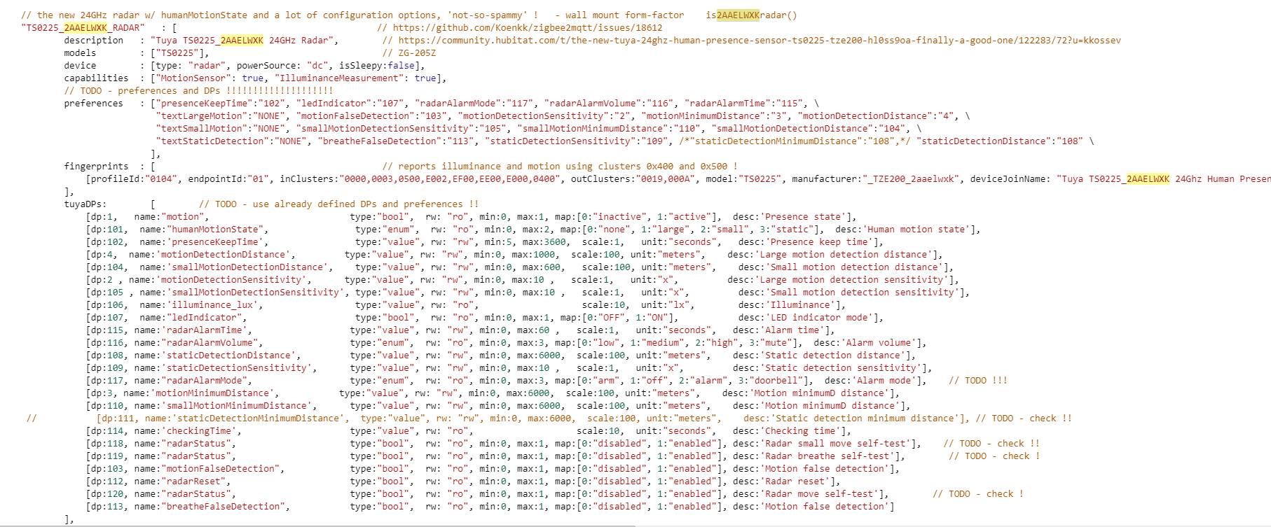

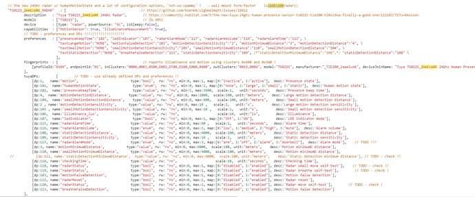

The latest driver version collects statistics for all Tuya 'Data Points' that were reported.

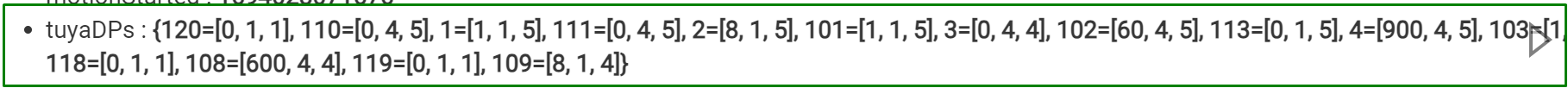

From your screenshot :
For example, the last item in the list meaning is :
  • 109 - Tuya Data Point number
  • 8 - last received value
  • 1 - data type ( 4 byte integer )
  • 4 - how many times this DP was sent by the device
The way these Data Points are decided is defined inside the driver code 'Device Profiles'
device profile

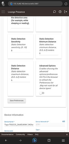

So in this example, DP=109 is the 'staticDetectionSensitivity' and its value is 8.
I don't see such an option on your screenshot?
Sorry pasted the wrong one. Here it is. I got to the point where it states run this code from the instructions above. I am not sure where or what to do from there.
