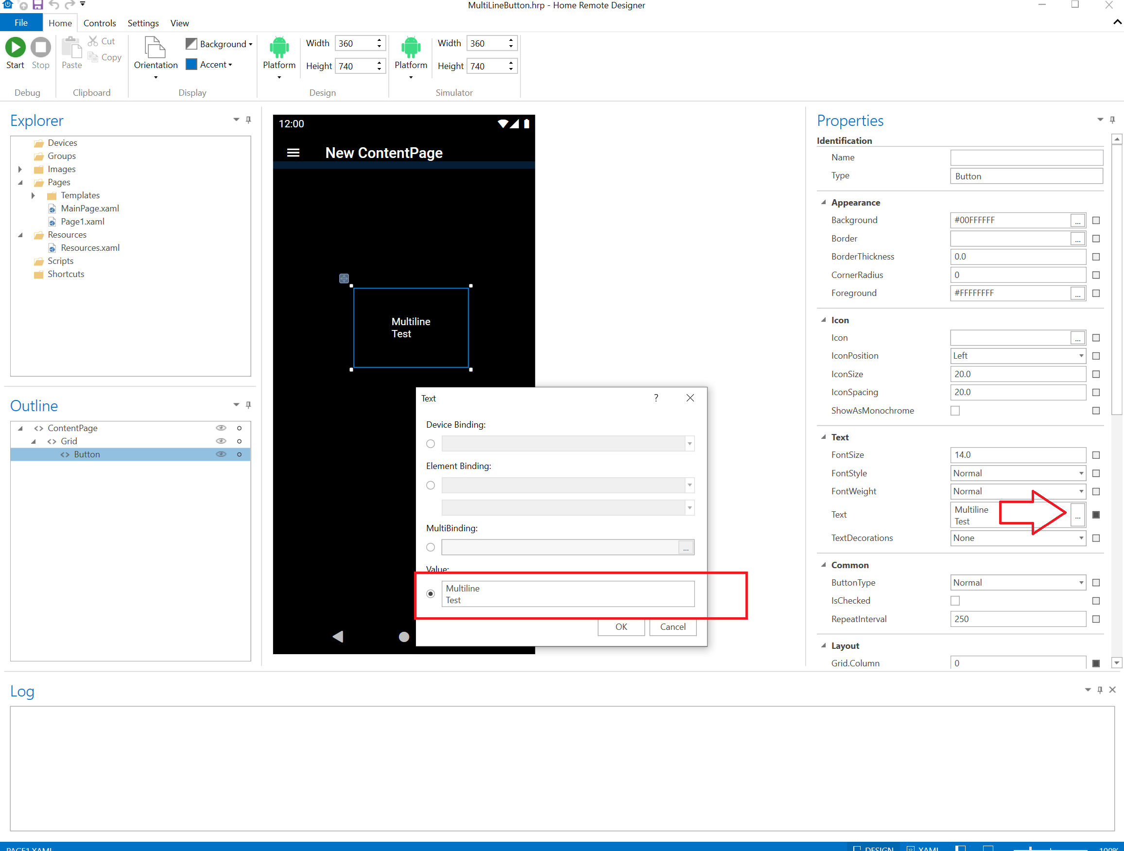

On a Button. Is there a way to have the label in 2 lines?
Yes. Click the ... button & then enter your text on the popup dialog. That popup will allow you to use the Enter key to provide multiline text.
Thank you. I thought I had tried that but apparently not. It worked fine.
