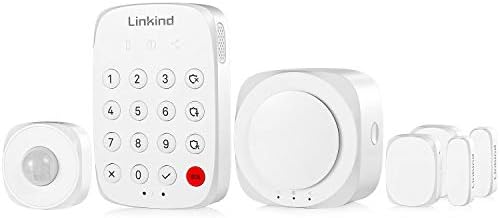

Actually ZIgbee, but doesn’t look bad. China address so you’d have to find a local reseller.
Looks very similar to the Linkind one:
It appears either it supports both Z-wave and Zigbee
Model Number
7A-KP-Z-B-A0
Protocol
Zigbee 3.0/Z-Wave 700
Radio Frequency
Zigbee 2.4G Hz / Z-Wave 868.42MHz(EU), 908.42MHz,(US)
They offer a U.S. version but for the life of me I can't find one for sale anywhere.
