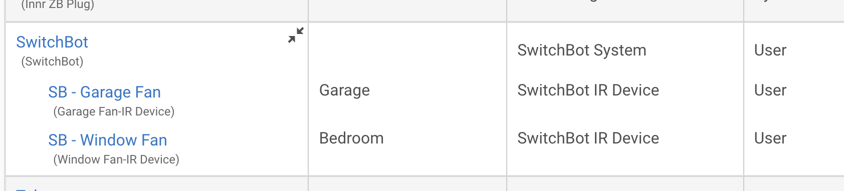

I'm using 2 SB Hub Mini's (1 for each window fan I'm controlling) -- no issues.
ETA -- each Hub Mini shows up as a child device in the main integration
Do you mean to ask whether my SwitchBot integration for HE will support more than one SwitchBot Hub Mini?
I don't do anything to filter it to one hub, so I assume it would just work. But I haven't tried it since I only have one SwitchBot Hub. (EDIT: @hydro311 confirmed that multiple SwitchBot hubs work fine).

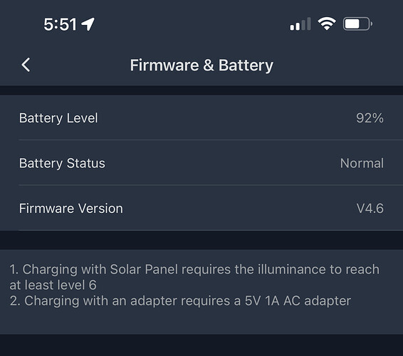

So, I don't go into the Switch-Bot App that often.. But be sure you do. Noticed I had firmware updates for all my curtain bots this last week. Also got a new order of Curtain Bot 2.0's in and looking forward to testing those out. I hope they eventually build in the real-time status updates for all these with the API.
Where did you see the updates? All of my devices just list the firmware version. Does that mean they're already up to date?
IIRC switchbot handles updates extremely weirdly, you have to contact support to request an update, they are not pushed out regularly.
The devices that need updated will have a red exclamation point in the upper right corner on the main home screen. They also give you an option to update when you tap into their page. The firmware also can be updated when available from each devices settings page where it shows battery and firmware version.
I have never requested a firmware update but I've received a few for the mini hubs and curtains over the past few months.
attached a screenshot of my original curtain device firmware version.
