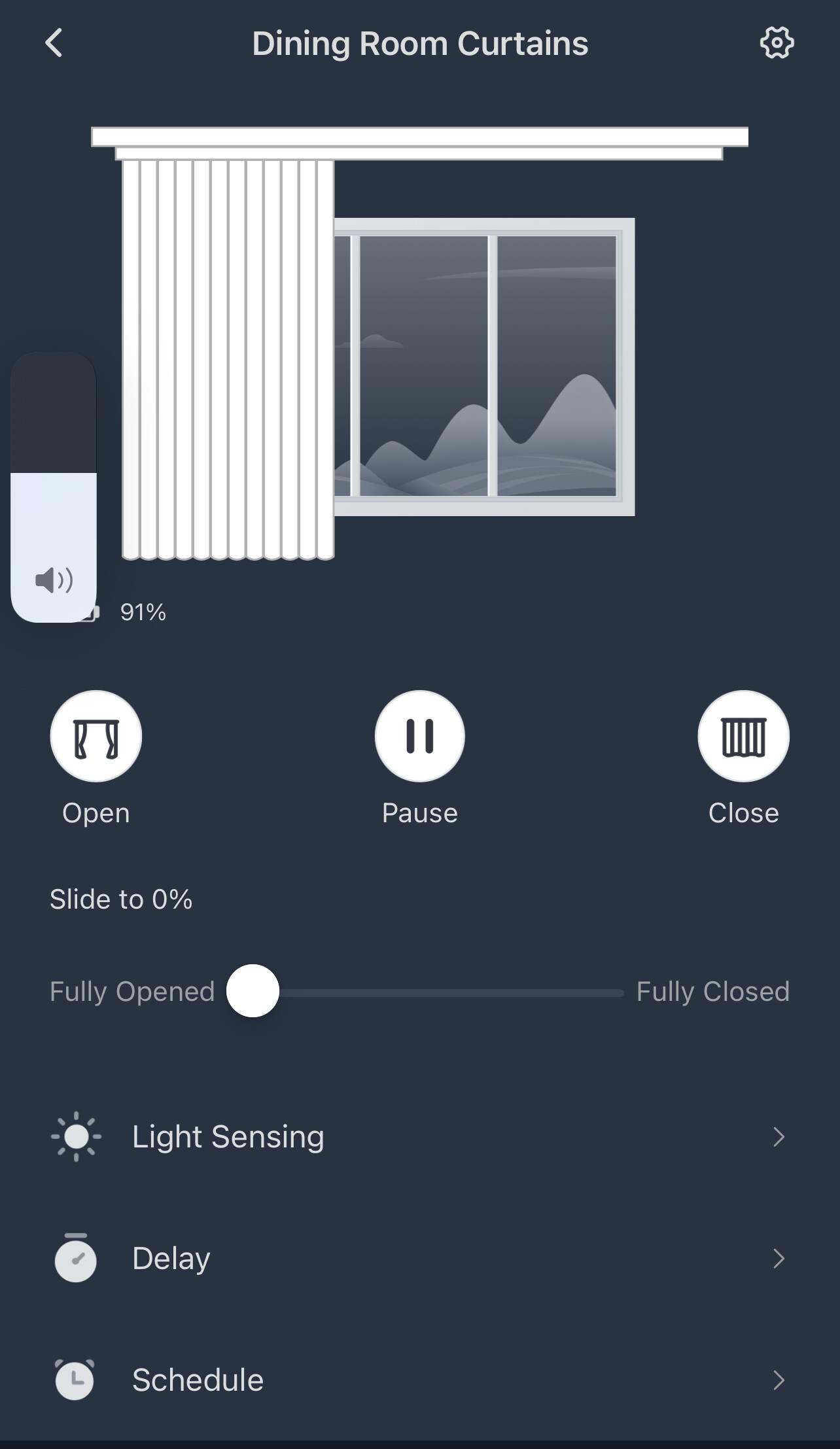

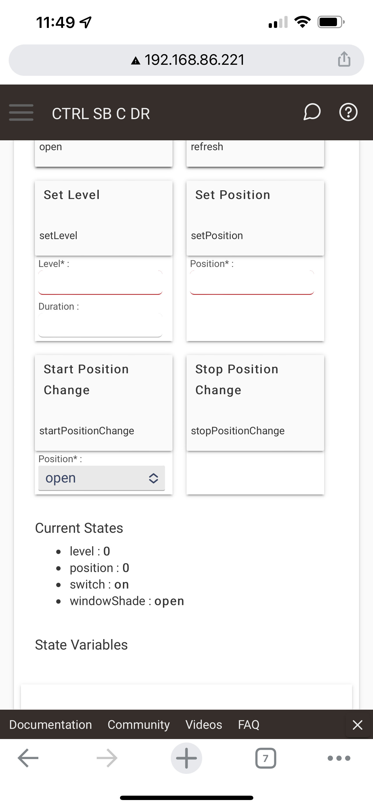

So this is what mine show when opened. They are at 0 and state is open.
That's the original behavior in my driver (0=open). Does the SwitchBot app also say opened? @jnosa899 seemed to be seeing the opposite -- SwitchBot app and this integration were flipped from each other.
Is there an indication of which side of the window it is on? Or are they a pair? Just trying to figure out how this could potentially get flipped.
This is with one sb curtain - not a dual pair. It's behavior in app is the same. 0% is fully open. Which is what your driver also shows.
My are open but this is what it shows in the app.
Ok, you are seeing what @jnosa899 is seeing.
