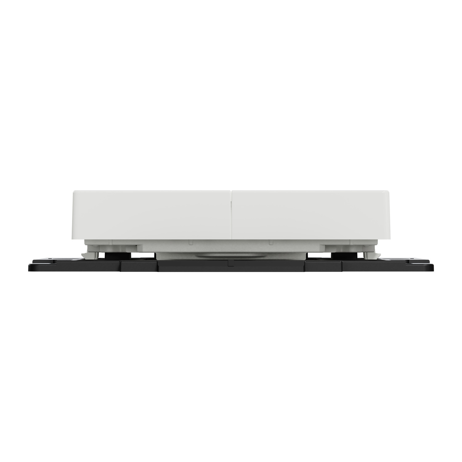

I have seen some old posts regarding the Schneider productline Wiser but nothing seems to have coume out of them. Anyone built a driver or investigated them in general or the wall switch in particular further?

I bought one and it connects, but unfortunately there does not seem to be a driver that works with it.

Unfortunately nothing in the log files when I press the physical button. The 'button pushed' message in the log file is from me pressing the 'Push' button in the device page having added the number '1' for button number first. The log appears as follows:
I have tried @kkossev's different generic and Tuya drivers, with no success. I have plenty of those devices, so I could even send one to @kossev if that would help. Of course I would need it back, but I can easily live with one missing switch for a while.
The Tuya TS004F driver is not the right one for the Schneider Wiser remote controllers...
Can you try some of @dandanache 's Ikea button drivers?
You will need to manually assign the IKEAs driver, then obligatory pair the Scheider remote switch again to the HE hub (without deleting it).
Schneider remotes seem to require explicit binding of clusters 0x0006 and 0x0008, then they may start sending events when a button is pressed or held.
@SamuelS - this is a piece of good news - the switch is now sending data to the HE hub!
