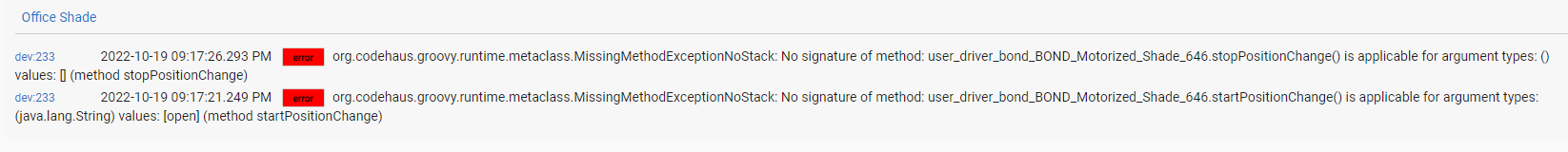

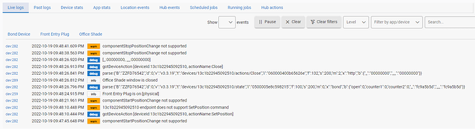

Even if you can't find a debug logging option, If you do tap the startPositionChange and stopPositionChange buttons what shows up in the logs?
I found it in the app settings and it was already enabled. Here is what I get with those 2 commands:

I uninstalled Dominick's Bond Home Integration app and installed the HE built in app. It appears that componentStopPositionChange is not supported?
Must be that the device just can't do that? They went through the trouble of implementing this command, required by the Hubitat capability, instead of letting it throw an error, so that (plus the complete absence in the custom driver), suggests that to me.

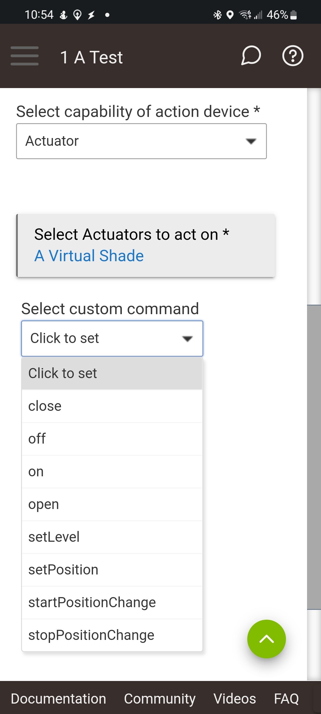

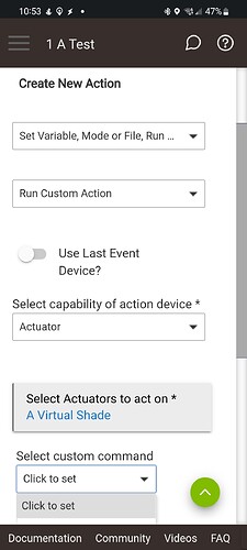

You could try using a custom action in Rule Machine, with Dominick's Bond integration.
Like below. Choose Custom Action and actuator, choose your shade, and see what custom actions are available. If there's a stop in the list that could do it.
You can see the HE virtual shade doesn't have stop as an option. Maybe it will show up in the options for your shade.

That was an interesting idea and I appreciate the detail you provided. I'm still trying to dig in and learn Rule Machine so having the screenshots was helpful.
Unfortunately "stop" isn't a option, only stopPositionChange. I think I may try adding a contact sensor in the location I typically stop my shade and see if I can get that to work until they are able to add this capability natively in the app. Definitely not ideal but I think it could work.
