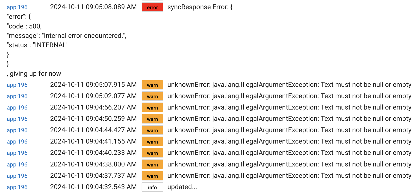

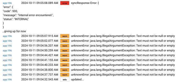

FYI: the Hubitat Google Home integration update does not like the dman2306's BOND Home Integration Fan devices. If you are using this app for Bond fans and can no longer add devices to your Hubitat <-> Google Home integration, deselect all Bond fan devices in the Google Home app device list. This will allow the Google Home app to go back to working normal with all your other exported devices.
You will see this issue as warnings and errors in your Hubitat logs (see screenshot, Google Home app debug enabled) or as "Something went wrong. Try again" errors in the Google Home mobile app.
Text sample of pictured logs (Google Home app debug enabled):
app:196 2024-10-11 11:30:39.756 AM [error] syncResponse Error: {
"error": {
"code": 500,
"message": "Internal error encountered.",
"status": "INTERNAL"
, giving up for now
app:196 2024-10-11 11:30:39.373 AM [warn] unknownError: java.lang.IllegalArgumentException: Text must not be null or empty
app:196 2024-10-11 11:30:39.371 AM [debug] getDeviceAttributes trait:FanSpeed
app:196 2024-10-11 11:30:39.371 AM [debug] getDeviceAttributes trait:OnOff
app:196 2024-10-11 11:30:39.370 AM [debug] getDeviceAttributes device:Gazebo Fan, deviceType:[name:Fan, type:FAN, specificCaps:[Fan Control], traits:[OnOff, FanSpeed], heAttributes:[speed]]
app:196 2024-10-11 11:30:39.368 AM [debug] getDeviceType final:[name:Fan, type:FAN, specificCaps:[Fan Control], traits:[OnOff, FanSpeed], heAttributes:[speed]]
app:196 2024-10-11 11:30:39.367 AM [debug] getDeviceType intermediate:[speed]
app:196 2024-10-11 11:30:39.366 AM [debug] getDeviceType added:speed
app:196 2024-10-11 11:30:39.365 AM [debug] getDeviceType added:switch
app:196 2024-10-11 11:30:39.363 AM [debug] getDeviceType device:Gazebo Fan, attributes:[supportedFanSpeeds, switch, speed]
Without Google Home app debug enabled all you will see is:
app:196 2024-10-11 09:24:57.240 AM error syncResponse Error: {
"error": {
"code": 500,
, giving up for now
app:196 2024-10-11 09:24:57.023 AM warn unknownError: java.lang.IllegalArgumentException: Text must not be null or empty

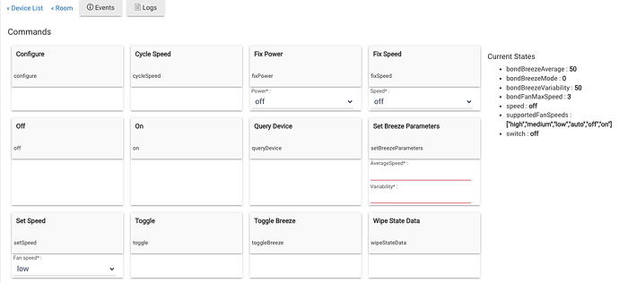

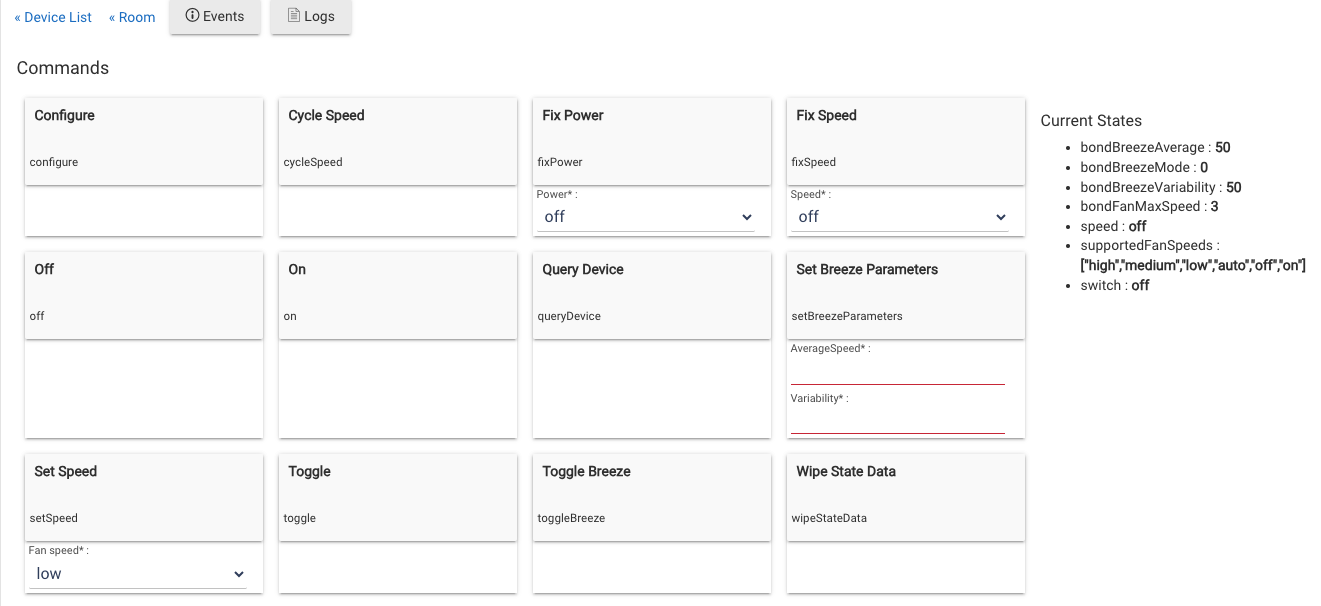

Latest update to Bond_Fan_v2.groovy
Implemented Breeze support and added "Query Device" for debug capability in case needed for helping anyone. See screenshot below.
You can enable Breeze mode by using the Toggle Breeze button or setting speed to "auto". Note that despite setting speed to auto, the speed reported under Current States will follow the real-time-ish Breeze adjusted speed as reported by the Bond device. You can identify breeze mode by looking at the "bondBreezeMode" under Current States.
Note: debug data, if generated, will appear in the Data section of the Device Details.
If you haven't already updated your Bond Fan to my version of the driver:
  • Add the above content as a totally new driver
  • Go to your Bond Fan device and Select "Bond Fan v2" for Type
  • Click [Save Device]
If you have updated to and are currently using my driver version
  • Replace all of the existing code in your current BOND_Fan_v2 with the code from above
  • Go to your Bond Fan device and click [Save Device]
If you are new to Bond integration, this driver update requires the community BOND Home Integration app from DMan2306, available in the Hubitat Package Manager be installed and setup BEFORE adding and using my v2 driver update.
Original Bond Fan v2 driver update post here
