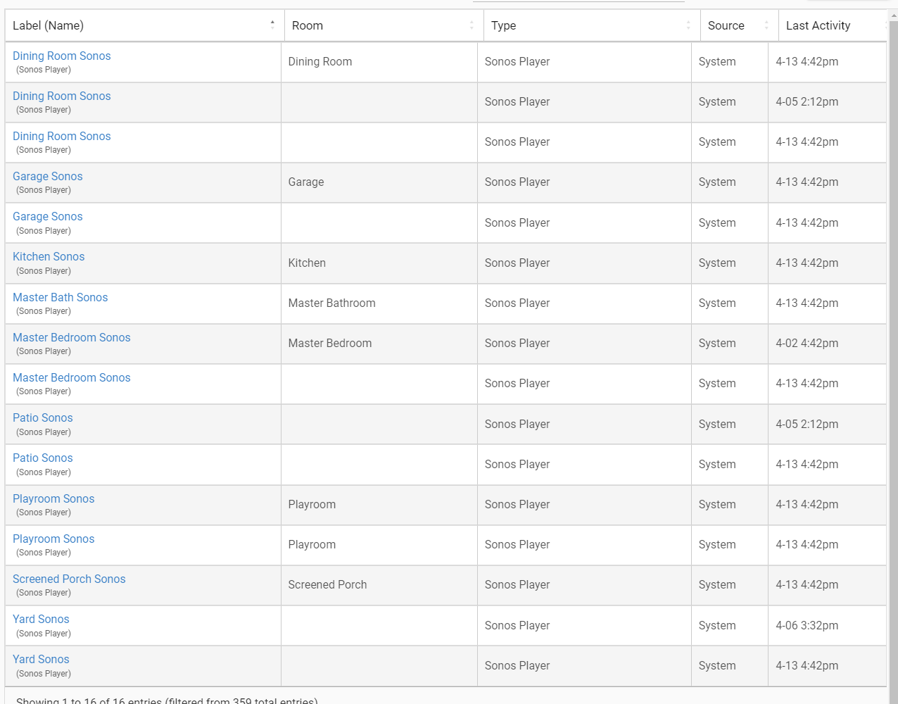

Hmm. Interesting theory. Checking I see there is a suspicious issue with the Sonos integration (built-in). I have duplicate devices somehow, even after re-discovering devices and pressing DONE again...
I resolved the Sonos integration warnings (by manually removing the duplicate Sonos devices from the buil-in Sonos integration). Still getting these network errors, though, so that wasn't the culprit. I would REALLY appreciate some Hubitat staff support.....
