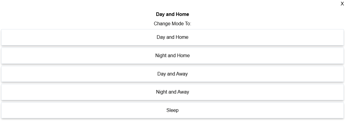

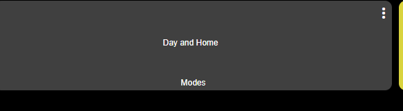

Via the Modes template in Dashboard you can easily change between these modes.
And when I click on that button it expands to show:
The only thing this doesn't do that you asked for is to change colors to match modes.

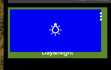

I get almost the behaviour I want, but the image looks weird:

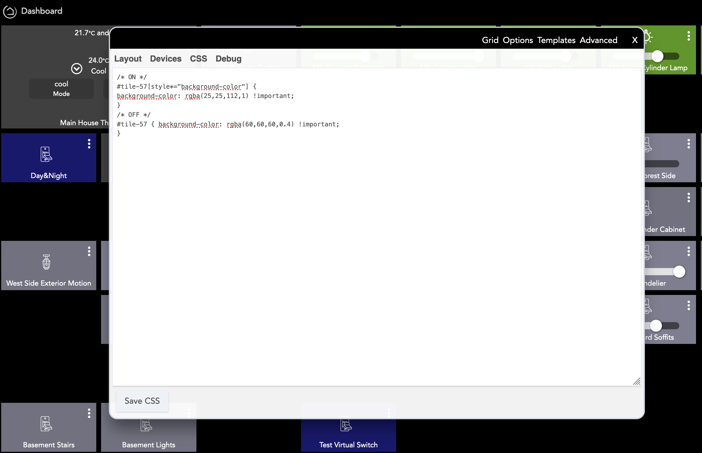

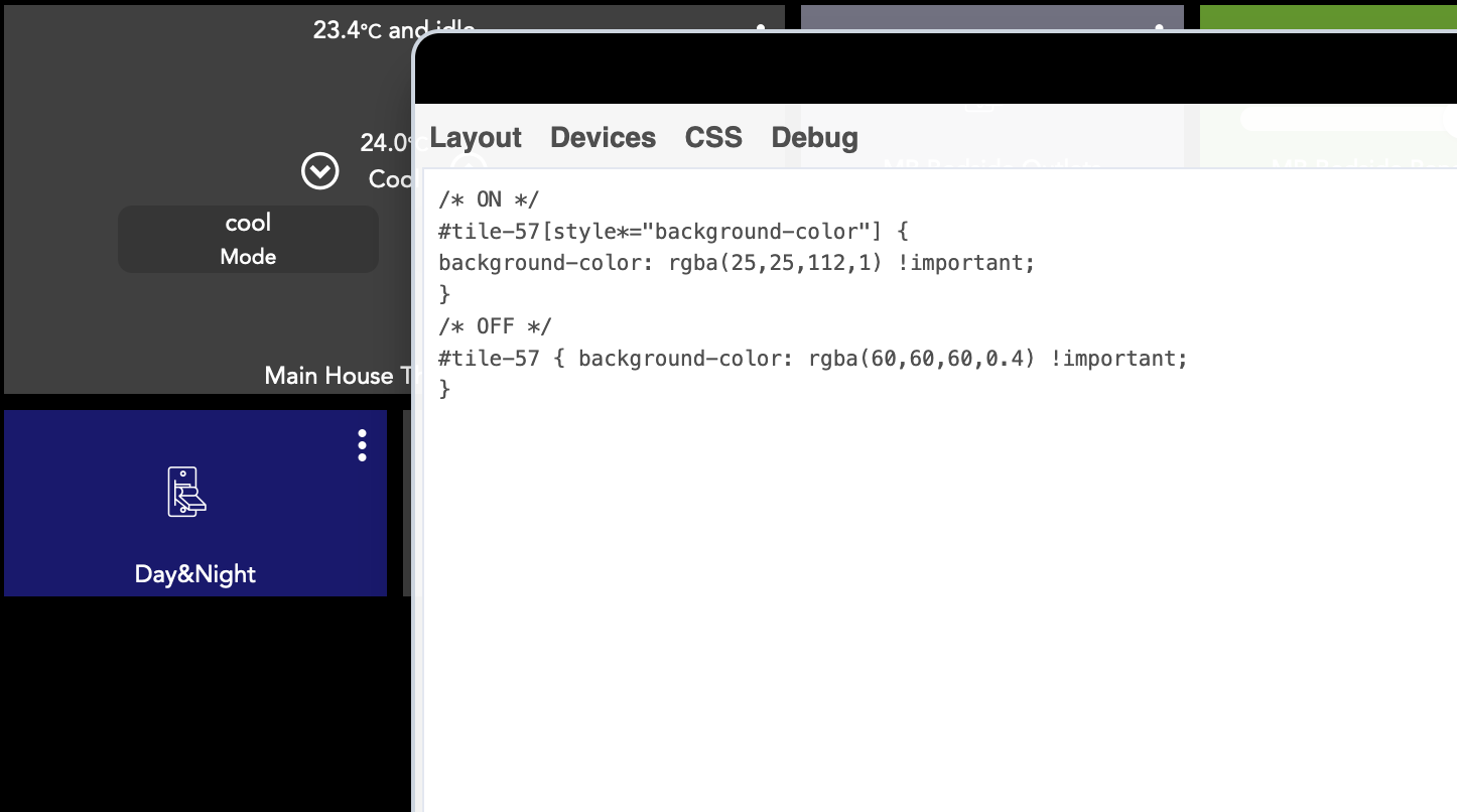

Flipping around the On and the Off? I have tried it both ways, and it stays blue regardless..
Here is the code, screenshot so the forum doesn't chew it up:
(I see you used different rgba values with the opacity at 0.4)?
Wait, are you saying that after copying what I sent you it still didn't work?
yeah, still didn't work...
Might be worth capturing your full Custom CSS and any Template overrides. I'll admit, with no other CSS for my tile or Switch overrides, @william2 's code does in fact work :slight_smile: So there must be something else going on....

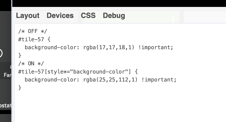

This code is the only thing in my custom CSS... See attached screenshot:
