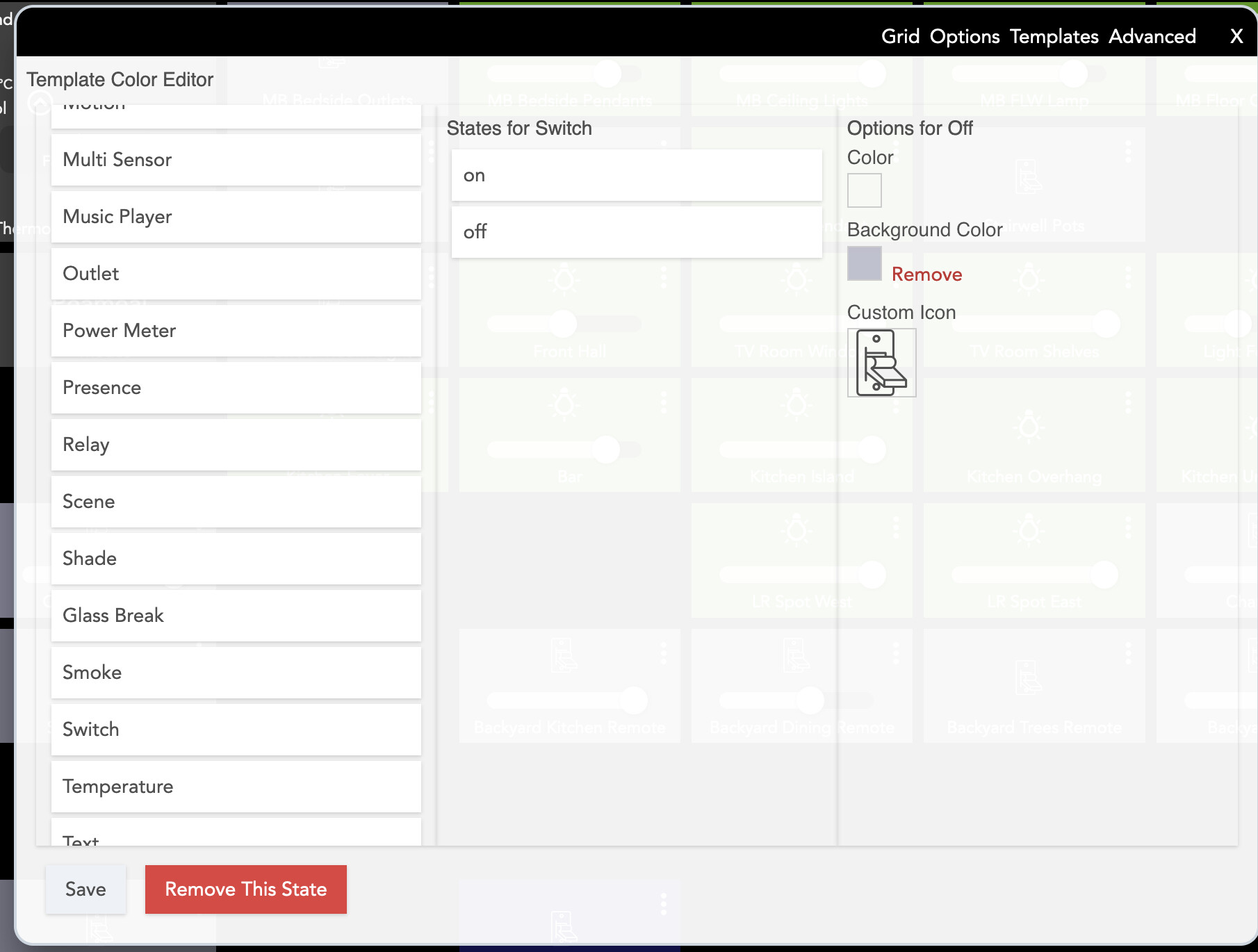

Interesting:

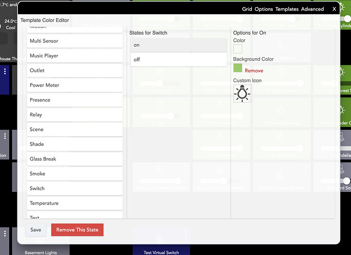

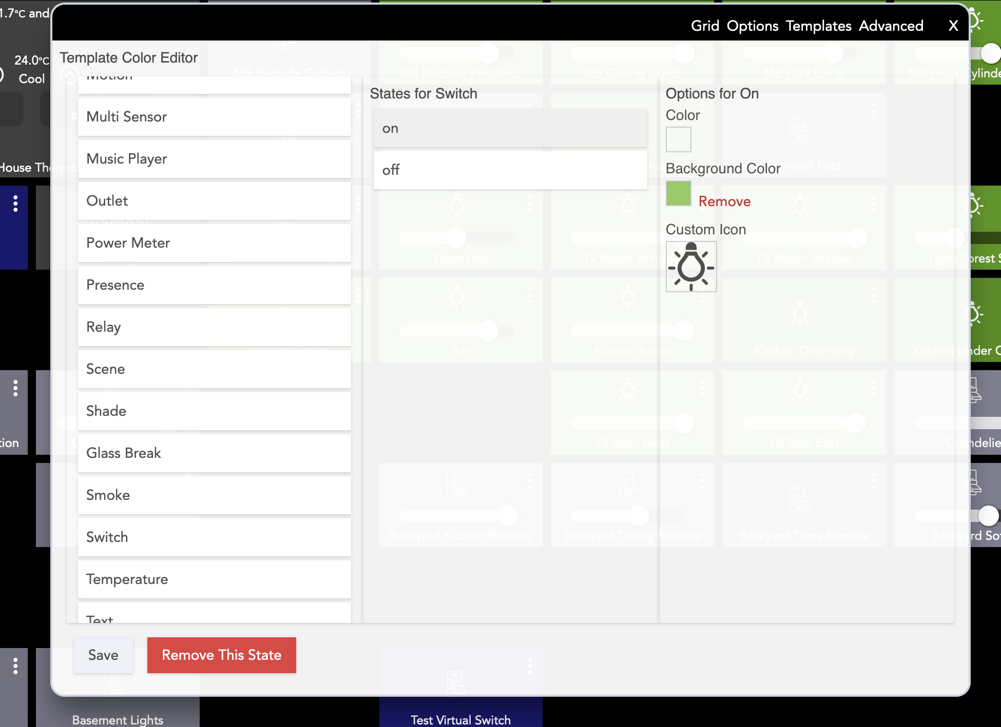

If I set a Switch Template ON state custom background colour, the code continues to work.
If I set a Switch Template ON state custom Icon, it breaks - the background colour stays grey (the off) colour all the time. If I remove this State it works again.
If I set a Switch Template OFF custom Background colour, it breaks the way my main dashboard breaks - it just remains blue all the time.
If I set a Template OFF custom Icon, it continues to work just fine.

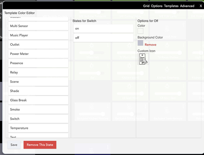

Weird - as soon as I add a custom background colour to the off template, it breaks. Here is the entire code in the working state:

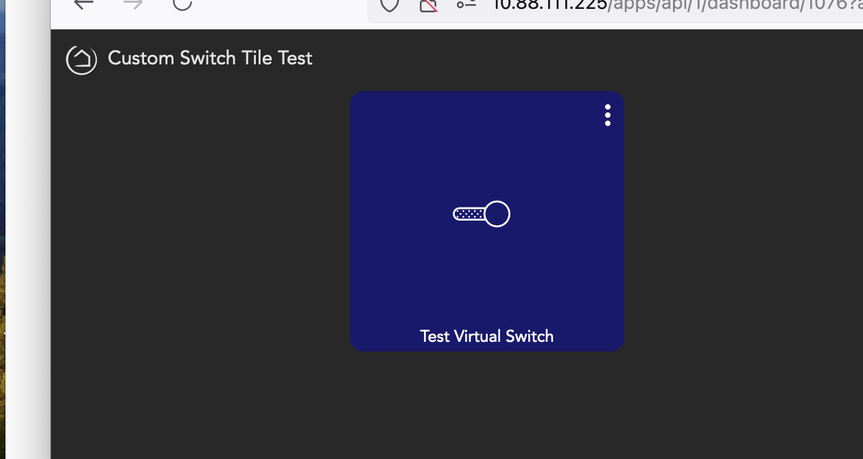

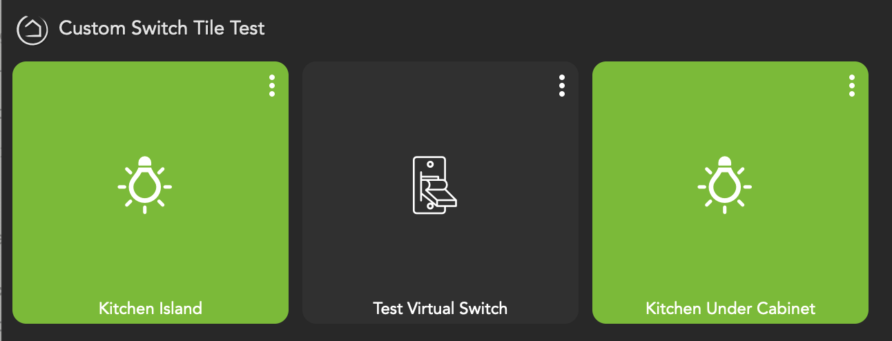

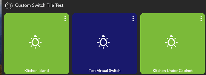

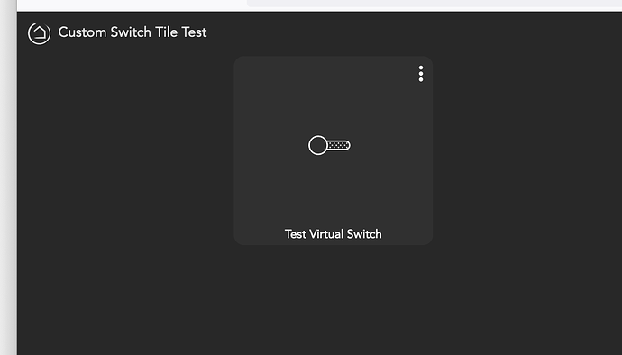

As you can see, On state is blue, off state is grey:
Here it is after I change the background colour on the template:

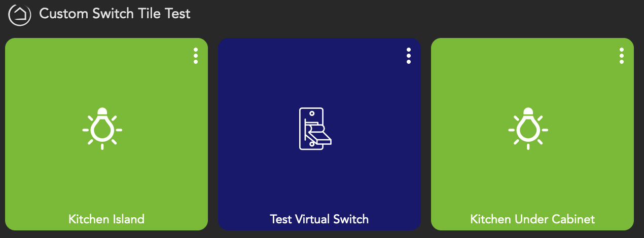

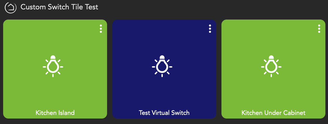

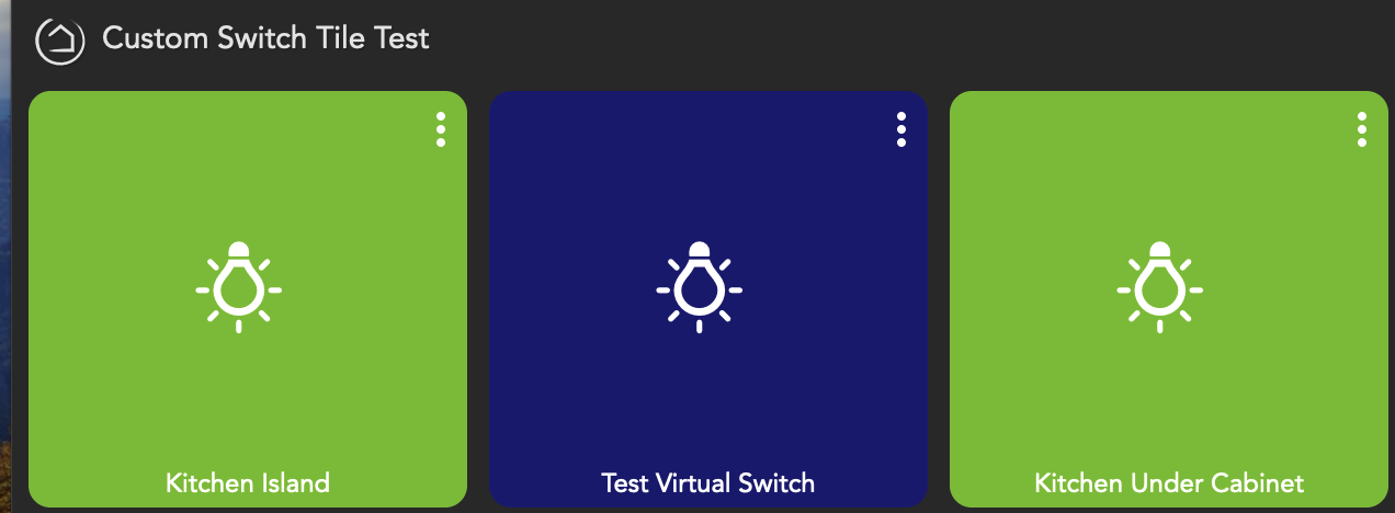

Now you can see the custom tile stays blue regardless of state:
