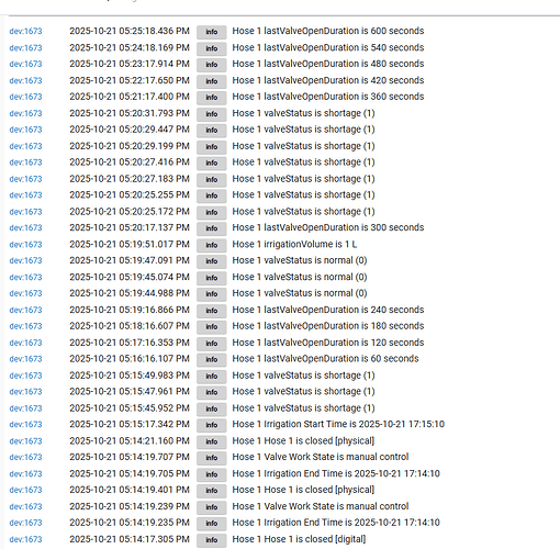

Hey @kkossev did you every find a solution to the manual button press not changing status?
My concern would be to know if these valves are rated for potable water. I suspect they are not tested nor rated for this.
You are very likely introducing lead, cadmium, nickel, or other heavy metals along with toxic materials like phthalates or bisphenols to your water supply.

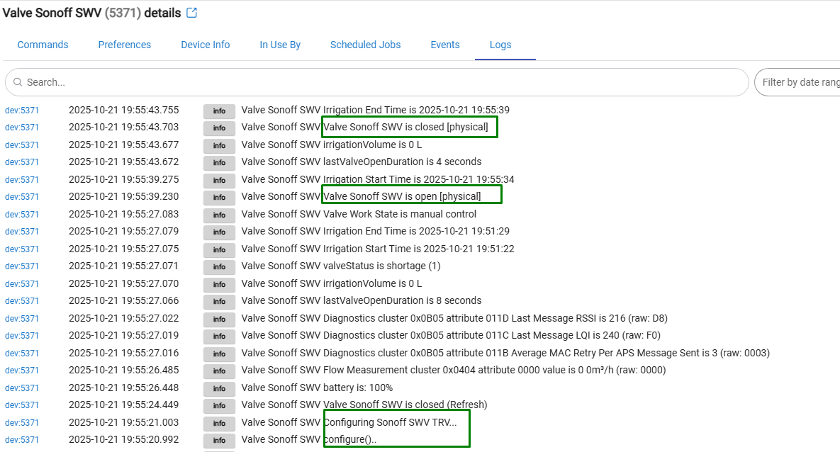

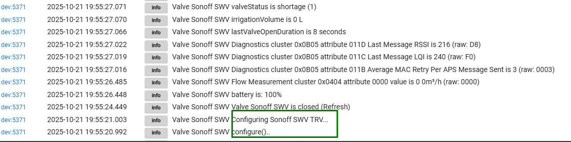

Try the Tuya Zigbee Valve new version 1.6.3 2025-10-21 - (dev.branch) Sonoff SWV TRV specific configuration
Click on Configure() button or save the Preferences.
This is what I see in the Info logs after saving the Preferences and then manuallo opening and closing the valve :

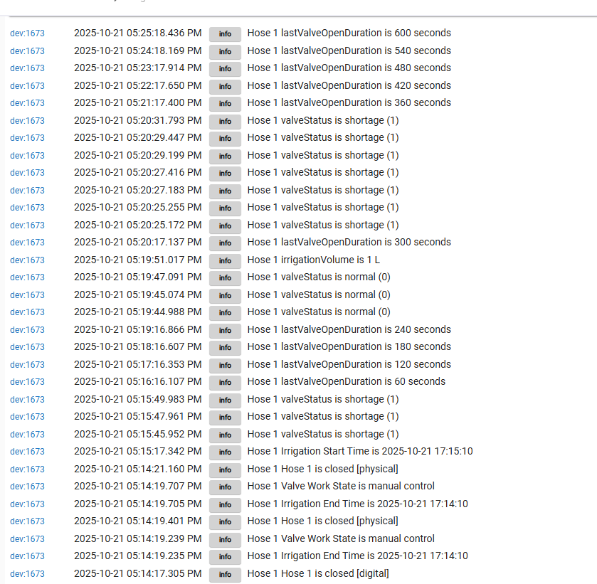

Still not changing on the dashboard on my end open or closed with a physical button press.
And here is another one. This one I opened with the dashboard, and closed it with the physical button. The valve on the dashboard stayed on open.
As a workaround, do you think that receiving the Zigbee message 'Irrigation End Time ....' could be used as a criterion for setting the valve state to 'closed' ?

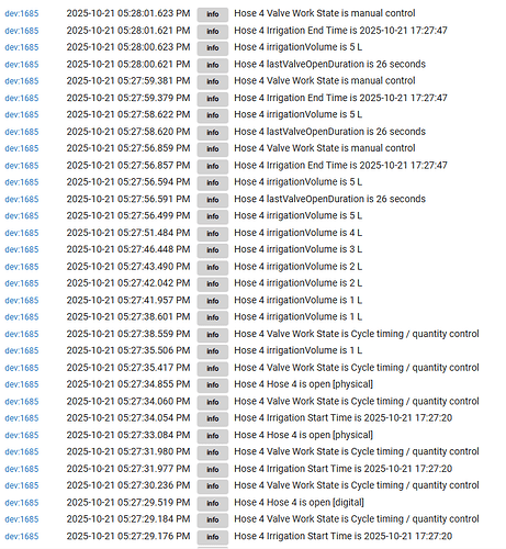

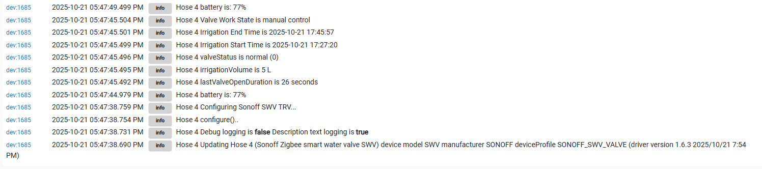

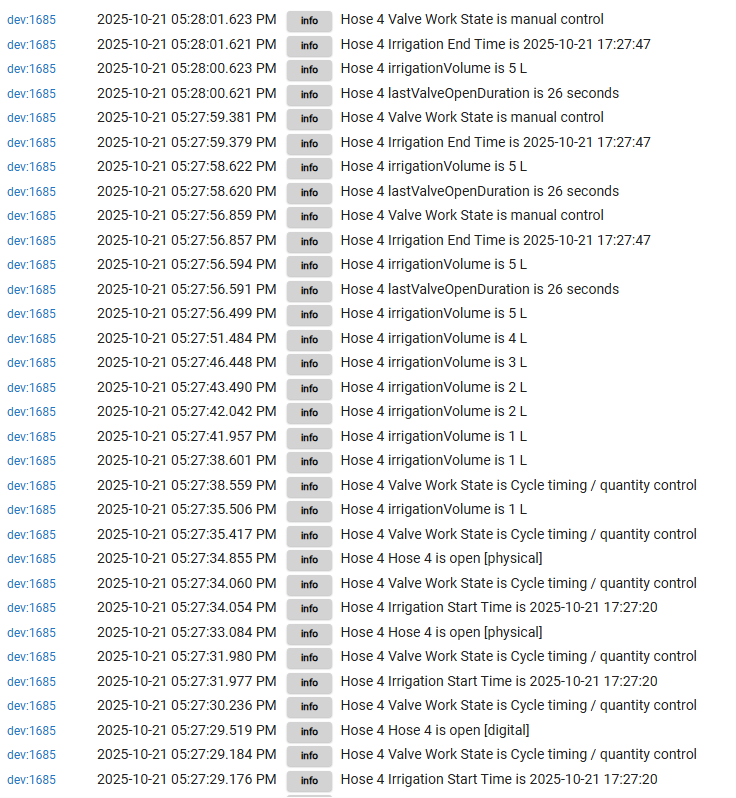

Can you post a screenshot of the logs that follow a Configure command or better Save Preferences?
Do you see 'Configuring Sonoff SWV TRV' as in my screenshot below?
Maybe, but you would need something for open as well?
Here is after saving under Preferences
