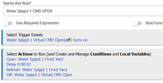

The device status not updating for manual on/off has always been an issue. My solution for this has been to avoid manual operations and to use a virtual switch to command rules that include a "refresh" action; this has done well to properly update the device status.

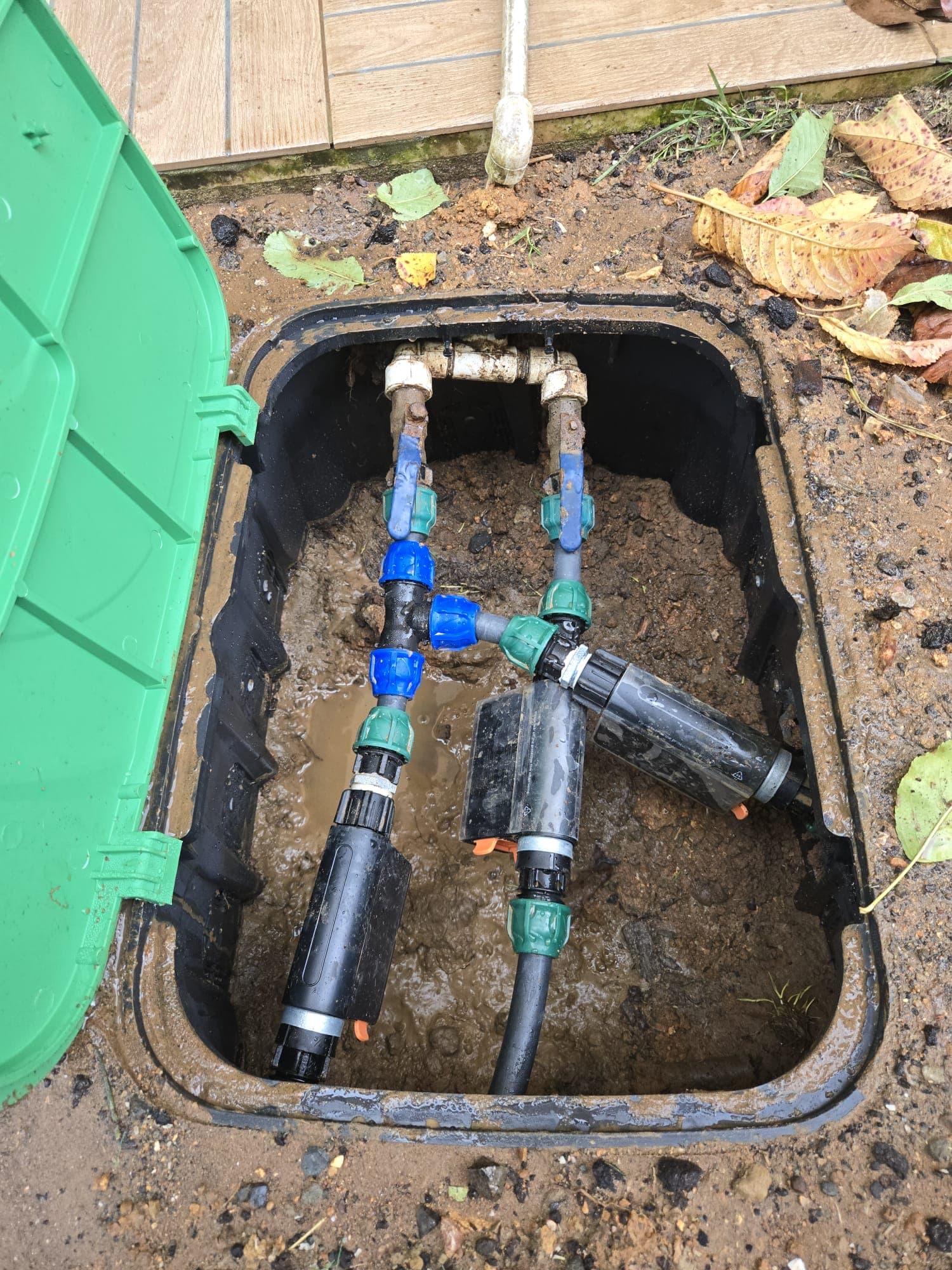

I got 3 of these installed now. Working fine.
I know, in the photo they seem dirty but I am going to clean them.

Your current installation as irrigation valves has them all positioned horizontally. Did you notice this note in the instructions?
It is recommended to install vertically as horizontal installation may increase the error in flow rate measurement.

Yes , I read that but my installation was not adaptable to vertical placement. So if it will cause erroneous rate measurement, I accept that.
