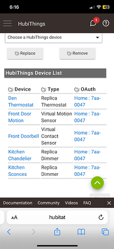

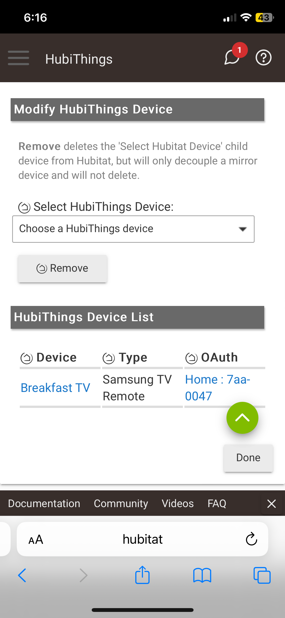

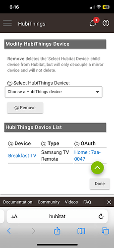

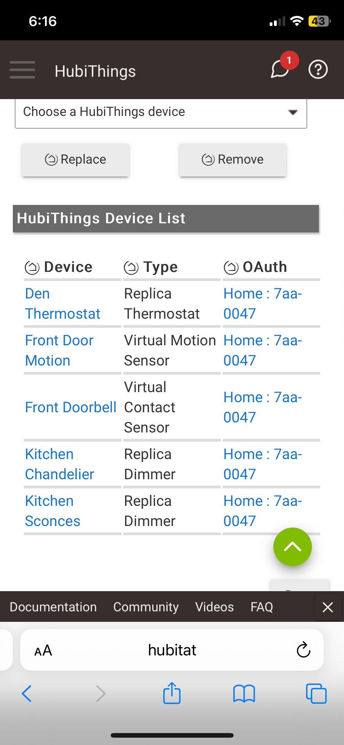

It’s been a while since I set this up, but Hubithings Replica is bidirectional - meaning you can share ST devices to HE and vice versa. In my case:
ST devices shared to HE:
Ring doorbell
Mysa thermostat
Brilliant 2G touch screen lighting loads
HE device shared to ST:
Samsung TV (using HE community driver)
You should not have to set up routines/automations to allow HE to see/control your ST device. I can see my Brilliant lighting loads in HE and control them directly. Similarly, my brilliant control can see the HE connected TV and control it directly (as a switch).
