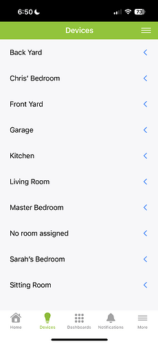

Here is the screenshot from the app’s Device tab from within the app— no “+ Device” selection button in the app at all right now— only selections to collapse, the view or hide no room devices or unsupported devices from the device tab hamburger menu.

I have gone to the devices tab and there is no “+ ” button anymore (see my device tab screenshot below.)

All your screenshots up above you are accessing the hubs web UI via the app, not using the apps built in features. You can ONLY scan a SmartStart code is using the app itself. Do not "connect to hub" which takes you to the web UI of the hub. You have to open the app and then click on the Devices (light bulb) tab at the bottom. Then click the (+) on that tab of the app.

I did try using the embedded browser to log into hub because it was the only way to get to “add device”. All subsequent attempts as you will see by later screenshots are from the native app device tab—- no “+” button on Device ribbon, only hamburger menu with choices as outlined before to hide or consolidate items in the device tab.

The “+” is only available when you are in “local” mode. You can determine this on the Home Screen:

For some reason, in my app on the home tab I do not have a status.
No Local or Cloud designation.
I am logged in.
This is in the current beta (Test Flight) version of the app but has not been released to the production (App Store) version yet. It shouldn't really change anything, just tell you what the current status is, but you can find instructions here if you wanted to test that version: [BETA RELEASE] New Hubitat Mobile App available in TestFlight for iOS - version 2.0.0

I went ahead and loaded the new app via Rest Flight. :+1:
When I log in to the app now, the Home Screen does show my status —it is Cloud. I guess that explains why I do not have a ”+” on my Devices tab
