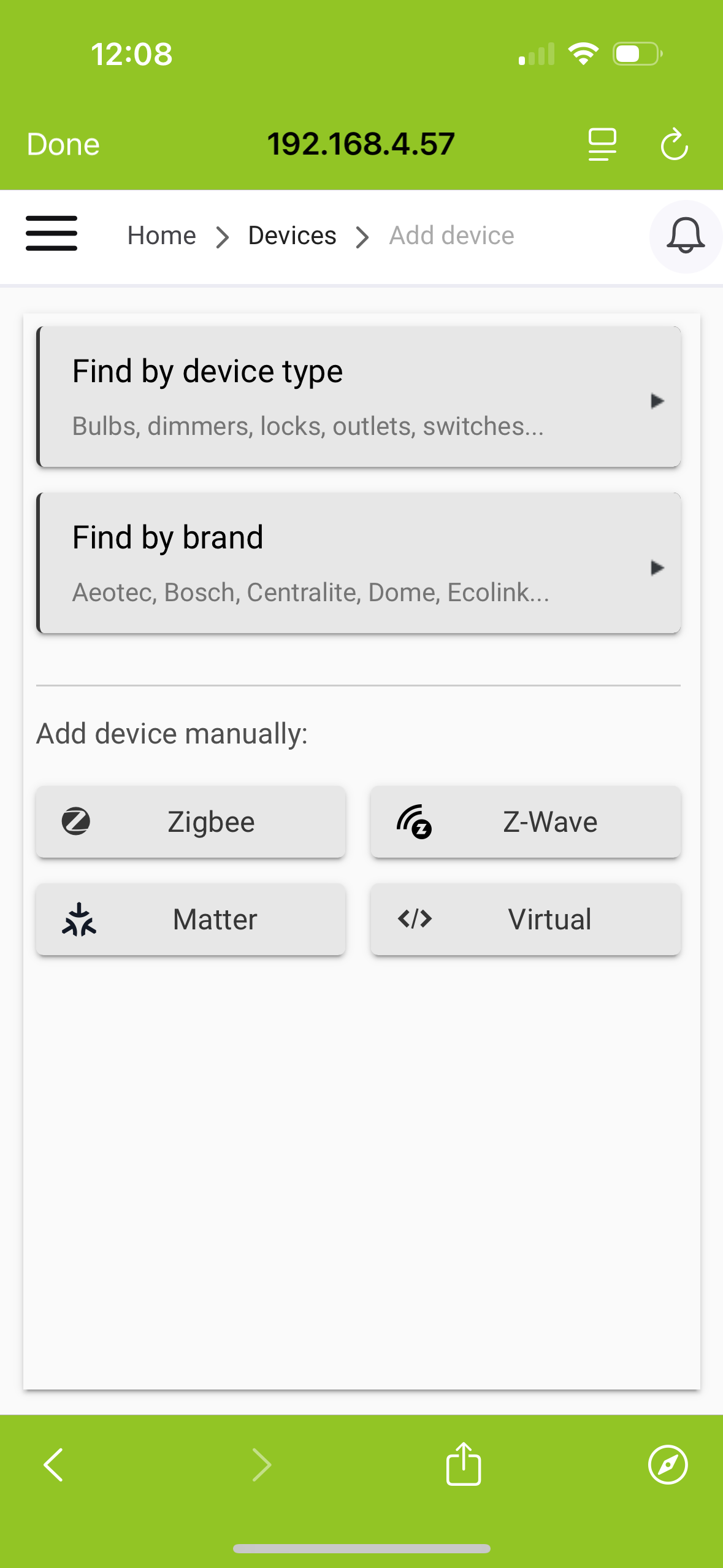

Hi, new user, first post. I added a few Z wave devices to my new C8 hub, which is ethernet-connected to my router. A couple 800LR Zooz switches and a zooz LR temp monitor. I was able to load the drivers for them and they work fine it appears. I can’t tell if they were added as standard mesh devices or LR devices, but I assume the former, even though they are all 800-LR capable. As I added them manually on the app, I'd like to use SmartStart to add additional devices, especially LR devices. However SmartStart is not available in my "add device” screen. I’m directly connected to the hub, not via cloud, able to get to add device screen (not that bug), but no option to add an LR device, no smartstart button. I’ve rebooted, reloaded the app, latest software and firmware. What am I missing?

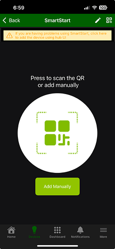

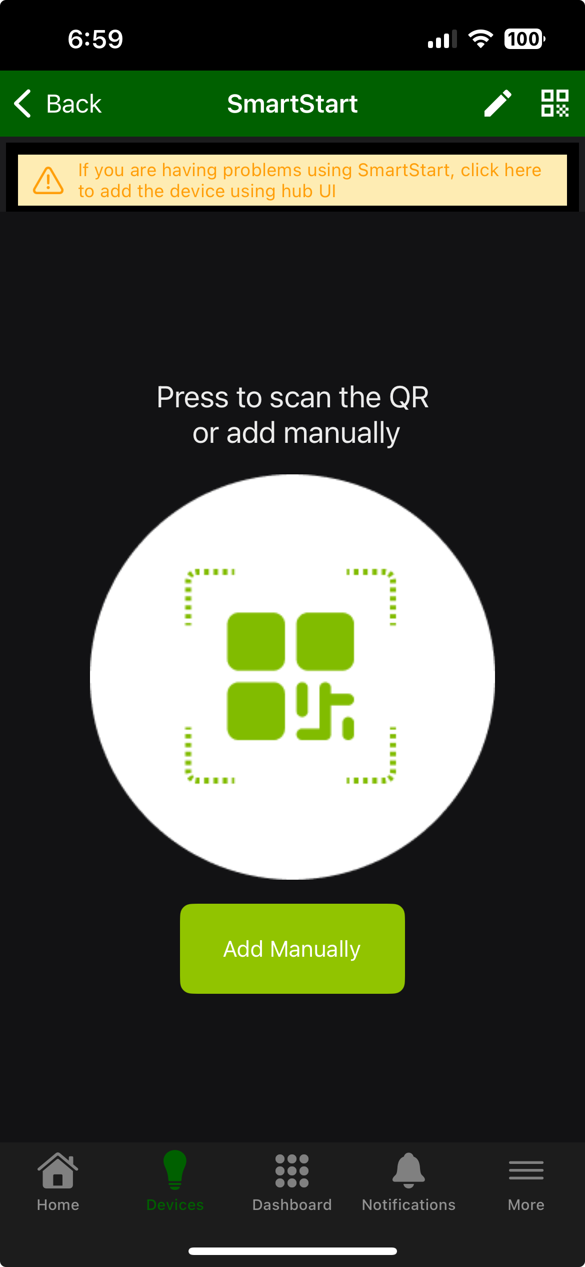

This is the app screen:
The OP’s screenshot is showing a web page from the hub’s browser-based UI, wrapped in the mobile app. That’s what happens when one uses the “connect to hub” button in the mobile app.
@velvetfoot is correct, that’s not where to add a smart start device. For that, you’d tap on the “devices” tab on the menu bar at the bottom of the mobile app (which is highlighted in green in @velvetfoot’s screenshot), and then on the plus sign in the upper right of the devices page. You should see the option to add a smart start device.

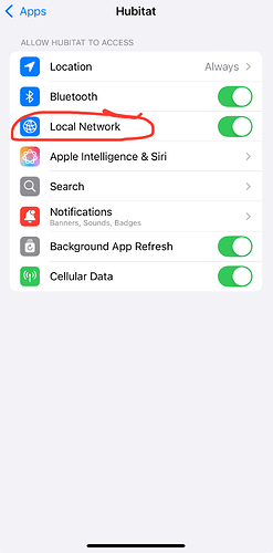

The mobile app should have requested local network access when it was first opened.
But if not (or you tapped “no” when it popped up), you can check in your iPhone’s settings—>apps—>Hubitat settings page.

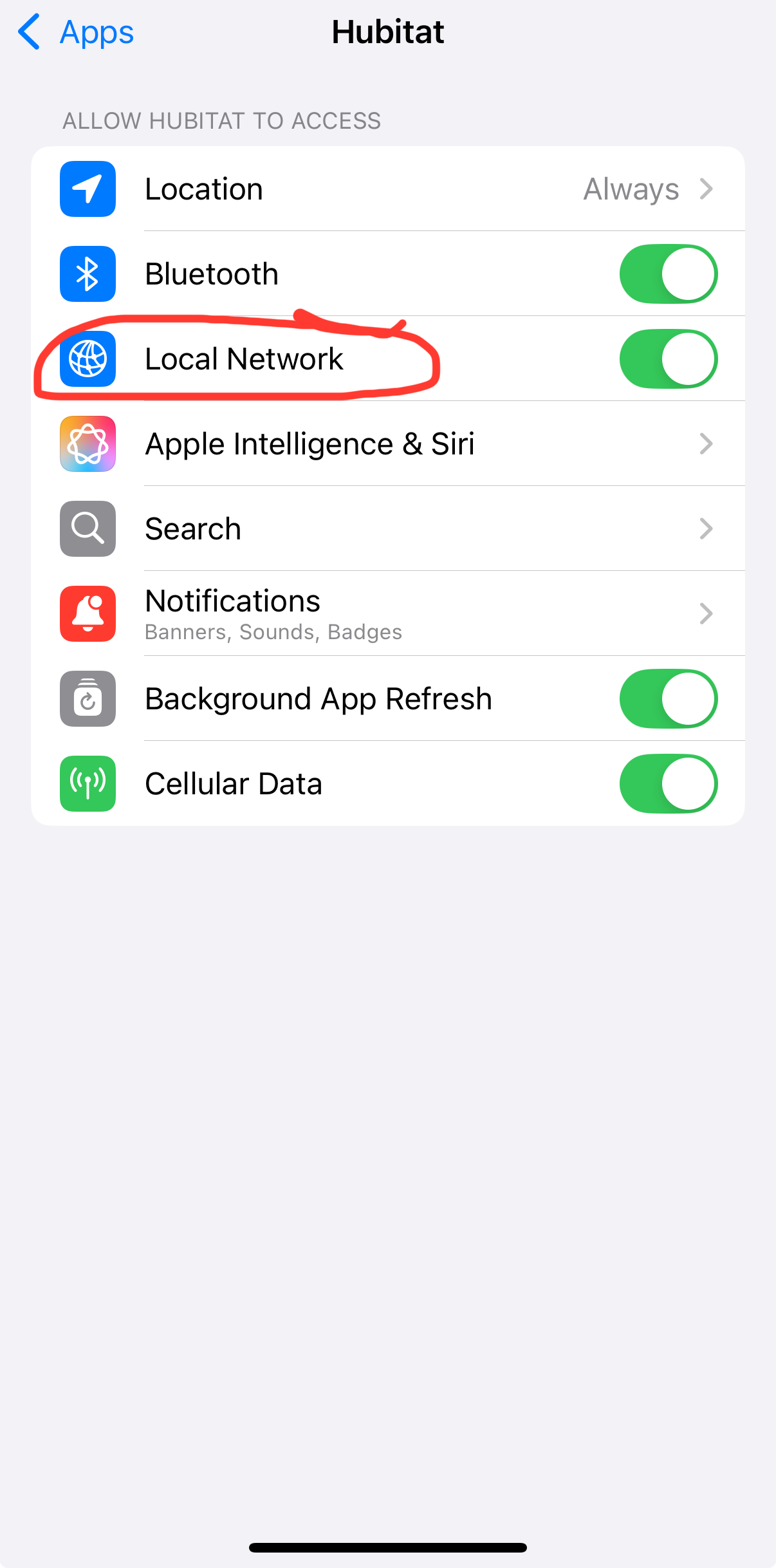

I have that correctly set and it still will not leave cloud mode. I even downloaded the beta TestFlight app as I know this was an issue....I thought it was addressed in the regular release version but I still tried the Beta Verison.
I have all the settings correct (unless I am missing something but Local Access is allowed and Background App Refresh too) but it still will only connect over cloud mode. Extremely frustrating because all I need to do is add one LR device (and I need to add it as a LR device given its distance to the hub and other devices) and this one issue is keeping the whole thing down.
