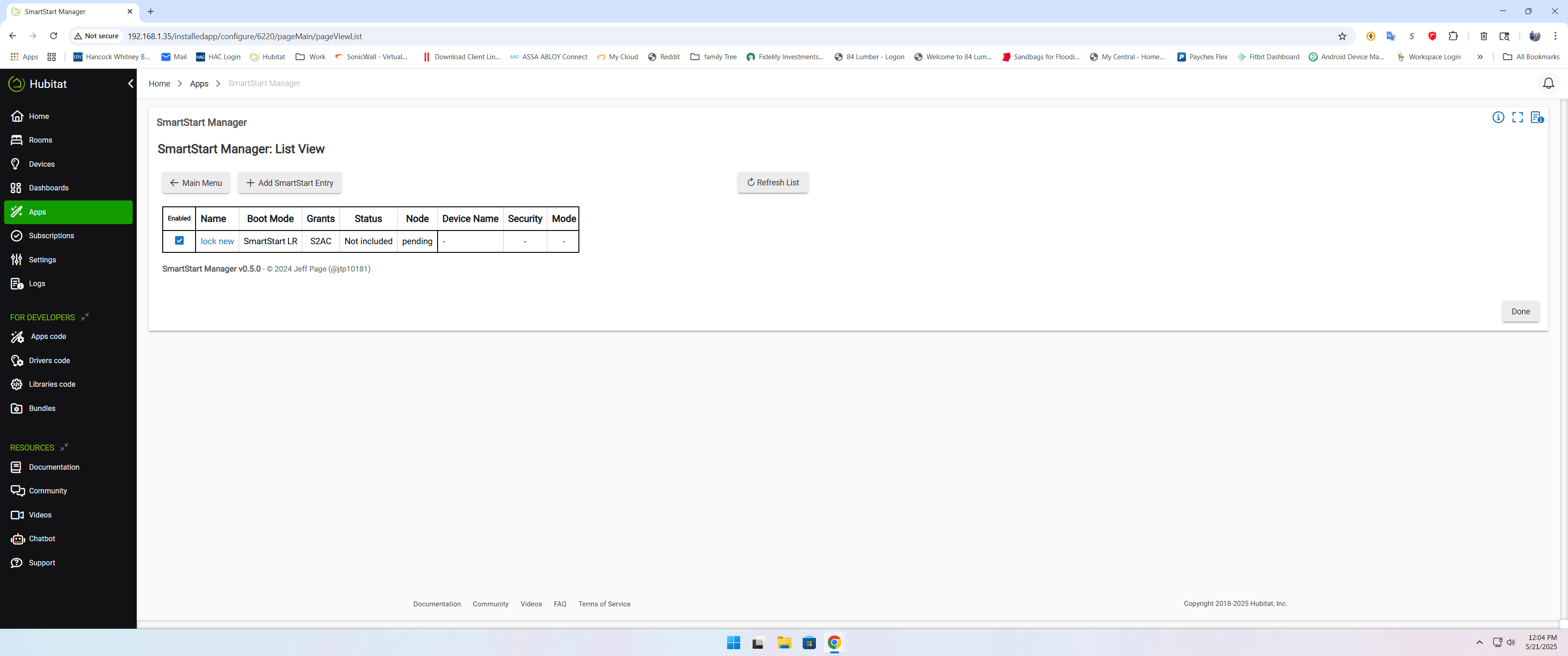

I've had your app installed, It does scan in as LR. but than sits as pending forever (one sat for a good 12 hours) and never joined.

It's just sitting as pending and never gets added (unless I add it and change it to SS Boot mode)
You need to check for ghost nodes, if there are any from failed Lock pairings those can prevent the lock from pairing again for some reason.
Then follow this procedure: [APP] SmartStart Manager for Z-Wave (Long Range support) - #2 by jtp10181
