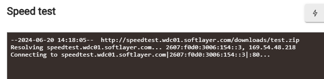

try ..
http://your-hub-ip/hub/networkTest
Has anyone actually gotten that speed test in the network tests to work recently? I tried it the other day to show an example for someone but it never actually shows the results for me. Tried it on two different hubs.
Hmmm well .. it used to work .. tried it now ..
and sure enough it did not seem to work .. so IDK ..
But it is there LOL
Hmmm.... I have mixed results.... Mostly just showing "connecting to...." the target, but no info regarding the speed....
Cannot use auto. When in auto and the router is rebooted the hub loses cloud connnection (another bug) even though it really hasnt. Ie ping traceroute dns lookups etc all work its just the cloud dashboards and other cloud urls that fail.
And yes speedtest is not working anymore.
