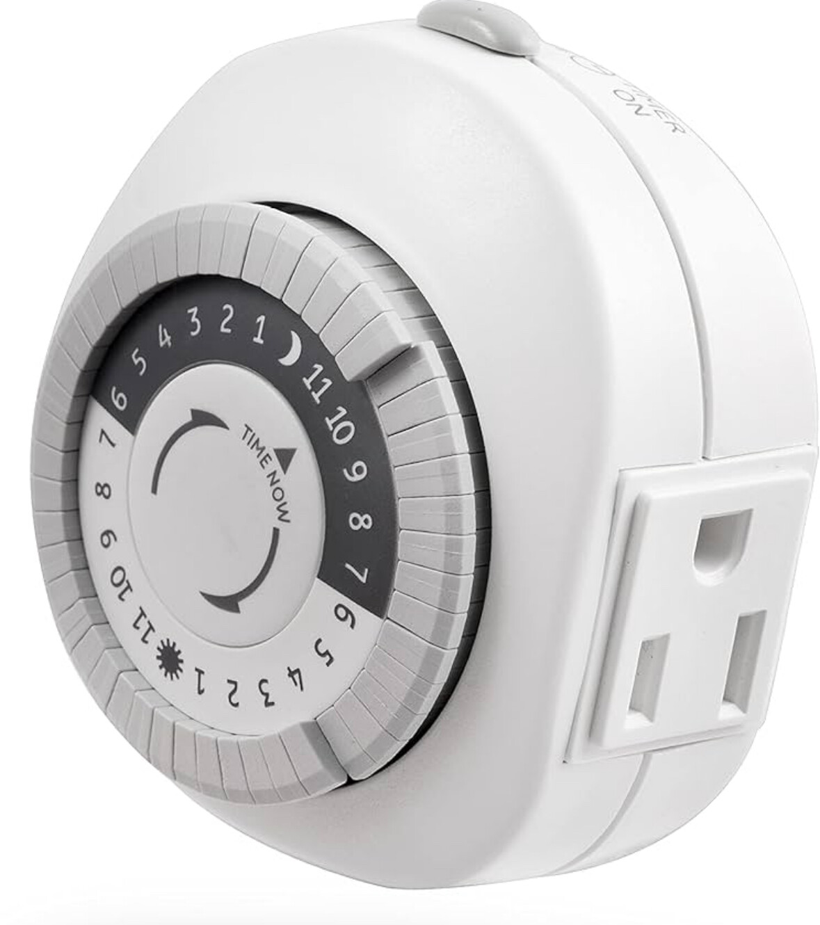

That’s a good idea. I had several wifi cameras a few years ago that would often lockup. So I put a $6 electric timer on them and had then power off for 15 minutes every night at 3:30AM. That way if they locked up while I was away I’d just lose the camera for a few hours. Band aide for sure but it worked.
That's a pretty clever approach, as long as you have a device that doesn't remind a hard reboot, it works perfectly. Those timers are extremely reliable and inexpensive. Kudos.
