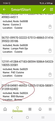

I did use Smart Start with a QR code. But after few minutes, the device is not includes.
And it never appears in the device list
Power off the device, then shut the hub down and unplug for 30 seconds, then plug back in to boot back up. Open live logs to watch for a Smart Start log message. Power up the device, and normally you should see the first log message within 60 seconds and then 30-60 after that it should be pairing which normally generates a bunch of debug logs.
If still not working I would look up the factory reset procedure for the device and try that.
Before you do the reset, make sure you have logs open, looking for the same thing as above.
You could also try manually pairing it if you cannot get SmartStart to work. The instructions are in that official docs I linked up above.
Hello.
here is what I did:
1- factory reset of the device using the button at the back
2- inclusion using SmartStart
3- power off the device
4- shut the hub off
5- unplug hub for 1min
6- open live log
7- Power up the device
8- waiting for about 5min
9- nothing appears in live log
and in SmartStart, the device is now «not included»
I’ll try manually pairing
