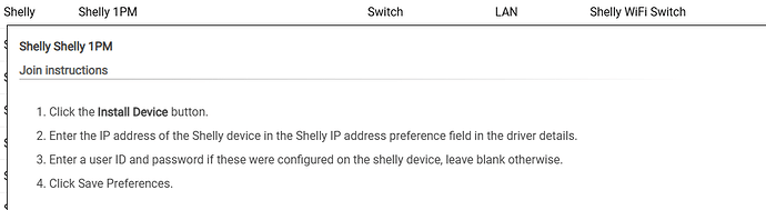

@bertabcd1234 Is this driver actually supposed to work for the 1PM? Compatibility list screenshot above.

I'm not sure. Any idea when this product was released? That driver was written in 2020 for whatever Wi-Fi API they were using at the time. Is the 1PM the same as the Plus 1 PM? If not, they might have different APIs, and that one may be the 1PM only. I don't have or use any of these devices myself, so I'm not sure. (But more drivers for more of these are coming at some point if this isn't already one...)
Shelly 1PM is Gen1 API device.
Shelly Plus, Shelly Pro, Shelly Mini, Shelly Gen3, Shelly Gen4 use Gen2+ API. They may have some Gen1 endpoints optionally on some devices.
Not only did I miss that the user said they had a Plus and the List does not say plus, but I also thought the "P" in the PM meant it was a plus. Shelly device names are very confusing indeed, not having any myself.
So that clears it up, the built in driver does not work on the PLUS devices, you need either the Shelly USA driver or the driver by @dmitry.rozovik. I am glad you chimed in because my next move was to tag you anyway!
