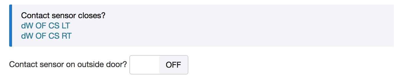

in engaged settings there is an option for Contact sensor on outside door?. if you turn that flag on it will change the room to engaged when the contact sensor is open. most users use this to set lights in a garage. but it could be used for any room. is that what you are looking for?
that description is probably not self explanatory … i will also update that.
