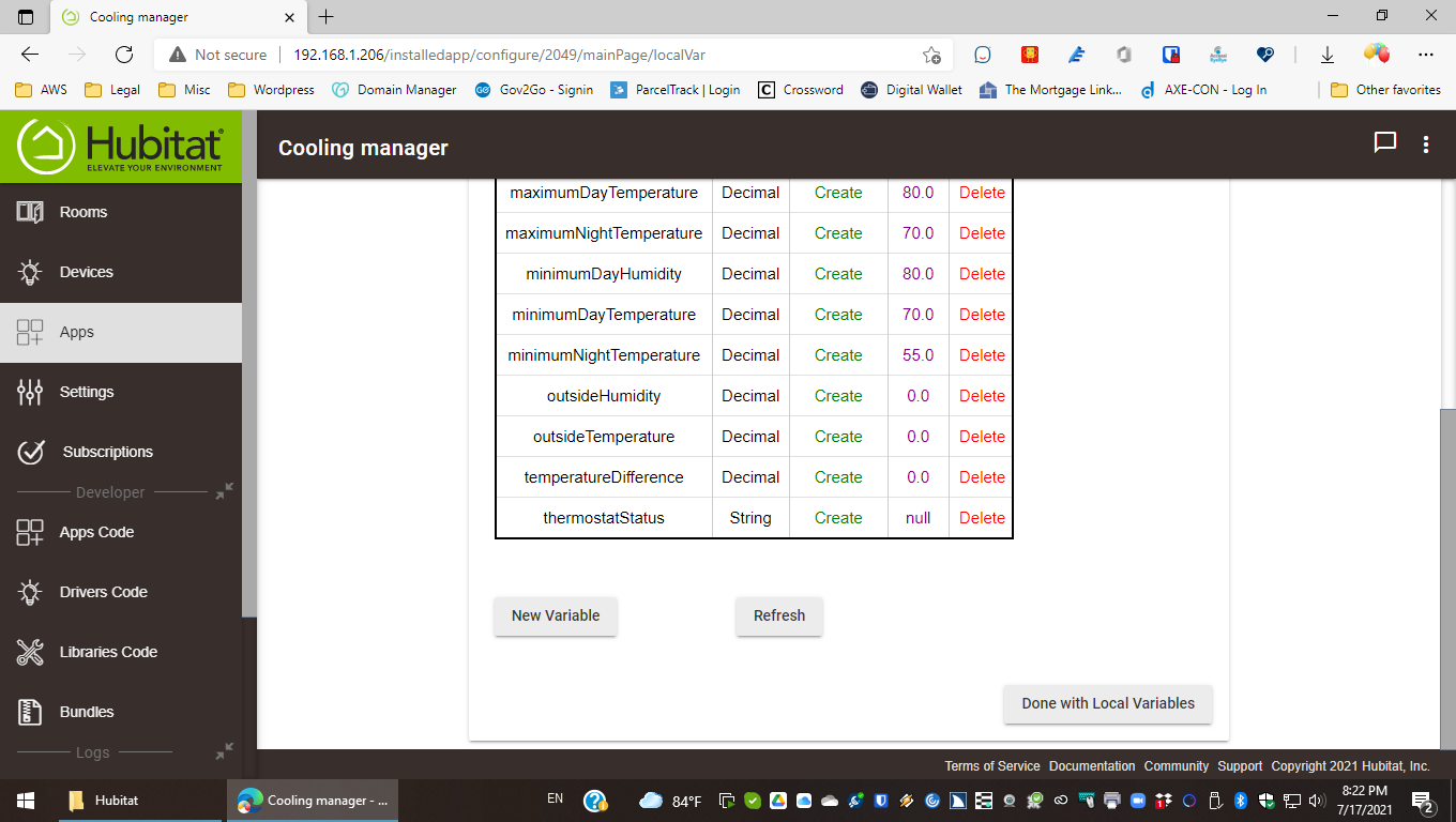

I created a rule with several variables to act as presets with which to compare outside temperatures (see screenshots below) and started building conditions. I got to a point where I could no longer select variables when building a condition. I wanted, for example, to compare the humidity with the outsideHumidity preset. When I get to the point where I check the "relative to a variable" box and try to choose a variable, nothing comes up. I am using the Accessibility/screen reader mode, so I thought I'd turn it off and try in case it is a bug specific to that, but unfortunately no variables showed up.
This problem arose do to the released version being too restrictive about the type of variable that could be used in the comparison. For instance, humidity is an integer attribute, so Rule 5.0 was limiting the choices to Number variables. But you have Decimal variables, so those were not offered as choices. The next release will relax this so that either Number or Decimal variables can be used for comparisons.
