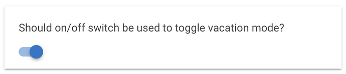

I just added a new feature as well:
When this is toggled,
Turning the water heater ON turns vacation mode off.
Turning the water heater OFF sets vacation mode to permanent.
This makes it easy for me to toggle it via ActionTiles.
public void on() {
    if (vacationModeSwitch) {
        setVacationMode('Off')
    } else {
        setWaterHeaterMode('Eco Mode')
public void off() {
        setVacationMode('Permanent')
    } else {
        setWaterHeaterMode('Off')
