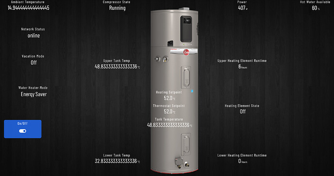

Update: One thing that I just noticed is that there can be many decimals on the temperature sensor results - could this be rounded to 1 or 2 decimals?
I checked the code to see if I could find where to round the decimals, but for the life of me, I just can’t find it… Likely something I don’t know how to find yet…
That said, there is some very nice information in this driver. I used it to do this quick dashboard:
Not sure what the runtime unit is… I assumed hours, but could very well be something else…?
If you look at line 282, for instance, I am rounding to the nearest tenth - the issue is that I'm doing the rounding before the celsius conversion instead of after. That should get you on the right track :).
Yes, runtime appears to be hours. Your upper heating element runtime of 6 hours and lower of 0 hours means that you have almost exclusively used the heat pump.
