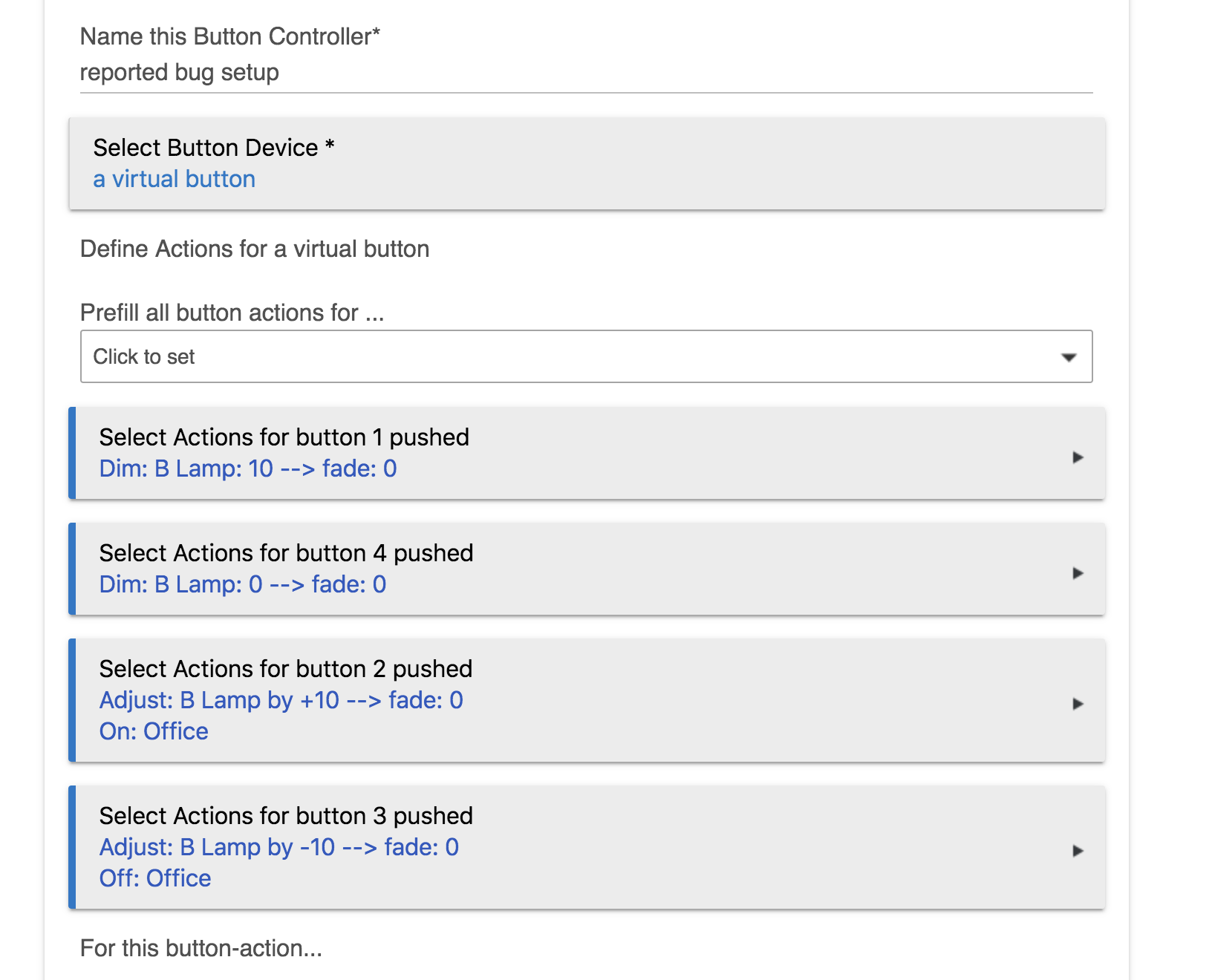

Well, I'm stumped. I set it up exactly like yours:
Then I went into button 3 pushed and deleted the Off: Office action:
Then I hit Done with Actions for button 3 pushed:
So you can see that I am not able to replicate your failure. What build are you on? What browser are you using??

The issue was that the Button Controller was having issues when deleting one condition out of a rule. Furthermore the issue was that under certain circumstances, entire button actions were deleted.
As I tried to describe, the response when using using chrome to do that (instead of Brave)::
- the browser flashed an error message very quickly, and then it disappeared
- it correctly deleted that part of the action which was selected
So, in conclusion "it worked".
I think that it certainly indicates that Brave doesn't always react like Chrome.
Except that I couldn't get it to fail on Brave (on a Mac). Brave on Windows? It's a fairly bad bug.
What I meant earlier about the failure you saw not making sense is that there is no relationship in the code that would allow the one action (deleting an action on the Define Actions page) to have the observed affect (deleting an entire action section on the main page). Those two actions are on different pages, and there is no code for the outer page that would delete an action section based upon anything that happened in the inner page.

If you've read this thread, this is a real mystery. Any screenshots you can share? Can you reproduce this?
I believe so... stay tuned... I am working to try and capture video of it all, so nothing is missed.
Ah, I just figured it out. IT IS A BUG in BC!
