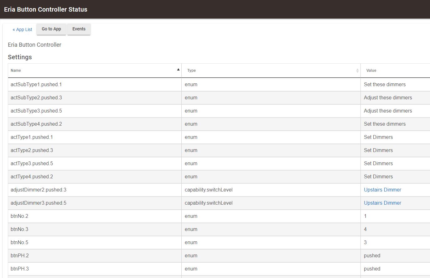

OK.I deleted the child button for this button controller, and I re-created:
Which showed up in the app status pages as the following:
Then to delete:
And it behaved the same way?
