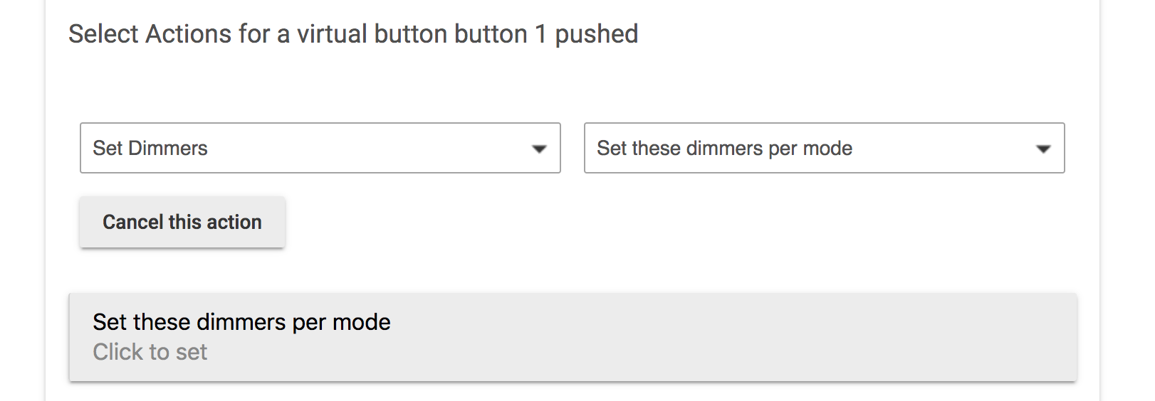

Would it be possible to have modes in button controller? I was thinking something like a pushed button that could toggle a dimmer to full brightness during a mode, then be set to toggle to a lower brightness during another mode. I know that I can do this in rule machine, but it requires multiple rules for modes, as well as multiple rules for the held and double tapped modes, or am I missing something?
It is there already.
Yep, I missed it! Thank you for the assist!
I am finding set dimmer per mode, but I need a toggle per mode... Would that be an option to add?
Just do the toggle logic in your actions.
IF (dimmers on) THEN
    Off: dimmers
ELSE
    dimmers-per-mode
ENDIF
I wish I knew where to add this, but I am at a loss. Is this something I would create as a custom action?
In the actions section of your rule.
