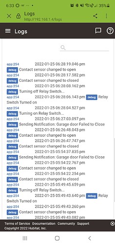

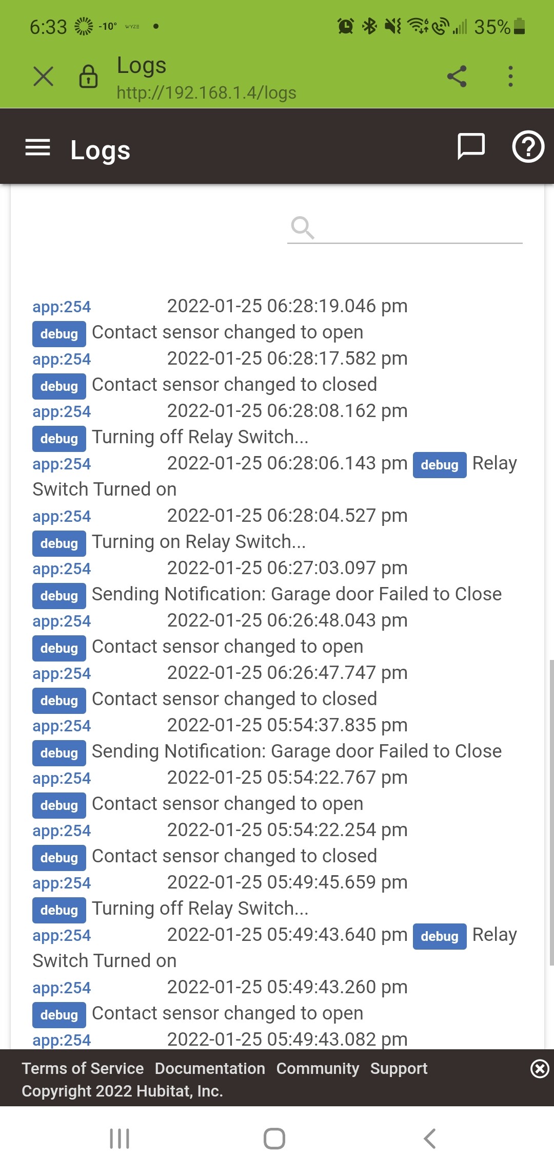

Hello. I have a zooz garage door opener and have been working great until recently. I noticed that even though my garage door is closed, hubitat dashboard still says it opened. I looked at the logs and noticed that right after I closed the garage door, hubitat immediately initiates an open command which I'm not sure why.

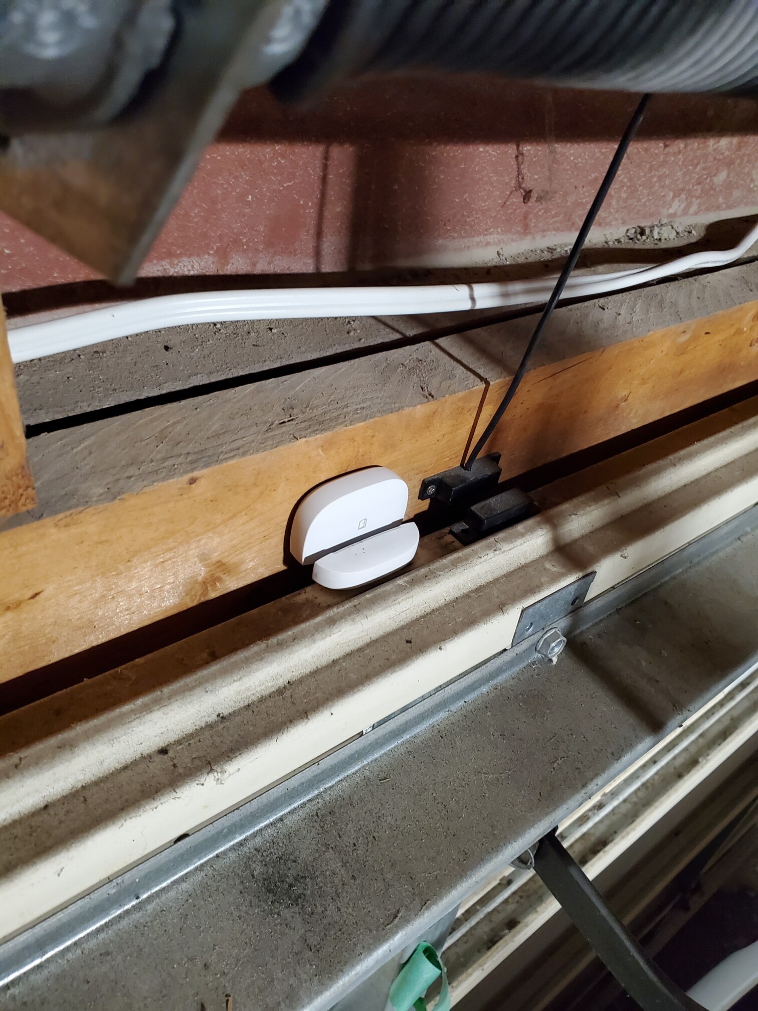

I'm attaching here a copy of logs and photo of smasung smartthings contact sensor I'm using to tell zooz whether my garage door is open of not.
So did it initiate an actual (uncommanded) open-the-door action (and it did open), or is the sensor just not reflecting the correct door position?
If the latter, are you by chance getting unusually cold or windy weather right now? Wind gusts and expanding/contracting metal/wood with temp extremes can really mess with the low wiggle-room tolerances of contact sensors.
This is why I use 2 contact sensors. I make sure both have flipped before alerting. I use smartthings, winter months def. kill the battery -- quickly

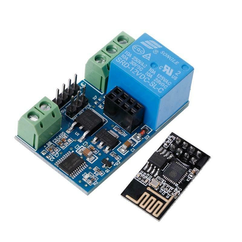

Ive also created a simple arduino relay that triggers the garage. Send it a HTTP request and it does the same thing as the wall button for most garage door openers. The only thing that sucks about it is that it does require a 5v wall wart to power it.

What is that other Reed sensor beside the Samsung sensor? Any reason you aren’t using it instead?
It did not initiate the door actually opening. It stayed closed after I closed it. Just reports as opened in dashboard and logs says it's opened.
Definitely really cold out here in great white north. Not particularly windy though. I get the potential expanding issue of wood. But as you can see in the picture, the 2 pieces of the samsung multi sensor are pretty close to each other.
That's a contact sensor for my meross GDO. That's my backup just in case hubitat fails. It's wifi only hence wanted something That's local such as zooz in hubitat.
