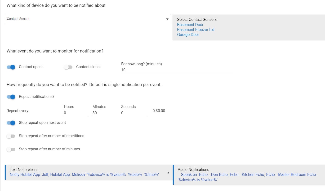

You can use the built in Notifications app to set up a really simple persistent reminder the door is open. Unless you leave it open a lot while at home, then this would be very annoying.
If you only want to run something like this while not at home, you would need to do it in Rule Machine probably so you can add a check on a presence sensor before running it.
