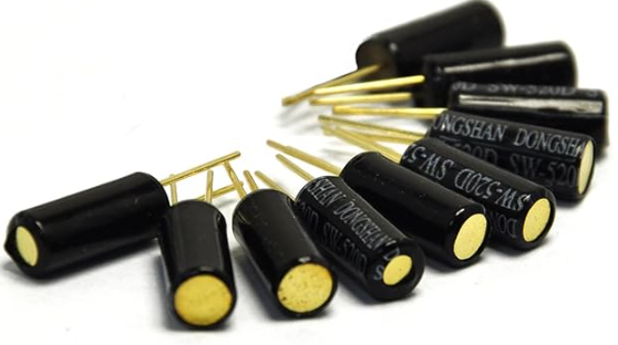

You can get a package of them for $8
Screenshot 2023-09-20 at 8.47.52 PM
https://www.amazon.com/Gikfun-Shaking-Position-Switches-Arduino/dp/B00RGN0KY0

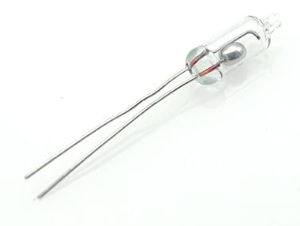

Better though is to get the mercury ones:
https://www.amazon.com/Midzooparts-Mercury-Switch-Sensor-Unidirectional/dp/B09P47DY3C
Screenshot 2023-09-20 at 8.49.27 PM
Because they can't stick... if you're going to repair it. Otherwise the solid state ones are better.

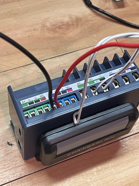

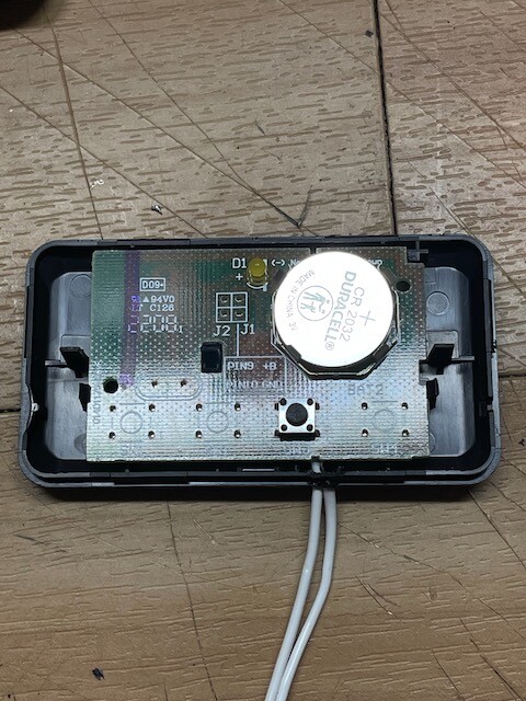

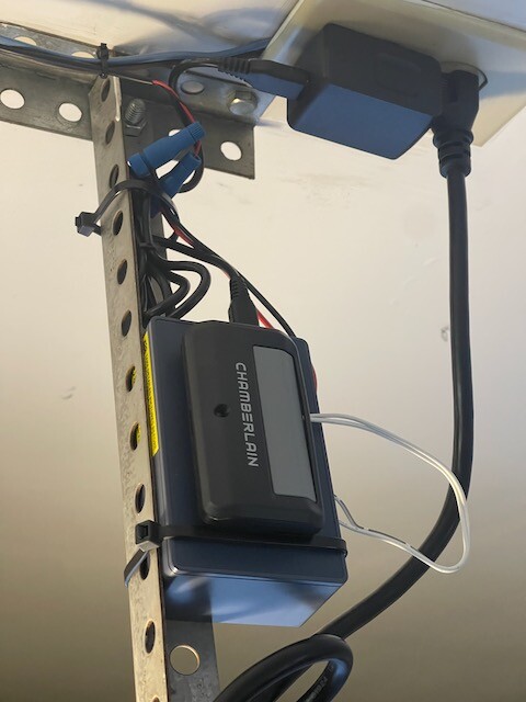

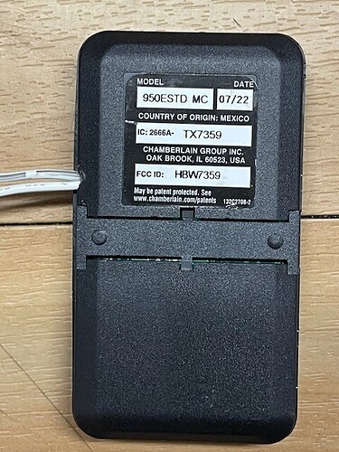

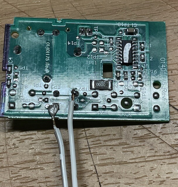

In my case, I have a Chamberlain garage door opener with a yellow "learn" button. I used a single button remote control model number 950ESTD-MC as the trigger, and an open/close magnetic contact switch I had previously installed on the door. Here are some images of the installation. The red and black wires go to the open/close contact switch (connected to Zen17 sensor 2 contacts), and the white wires are the open/close trigger wires (connected to the Normally Open contact on Zen17 relay 1).
Forgive my messy soldering job! My eyes and hands dont work quite as well as they used to!

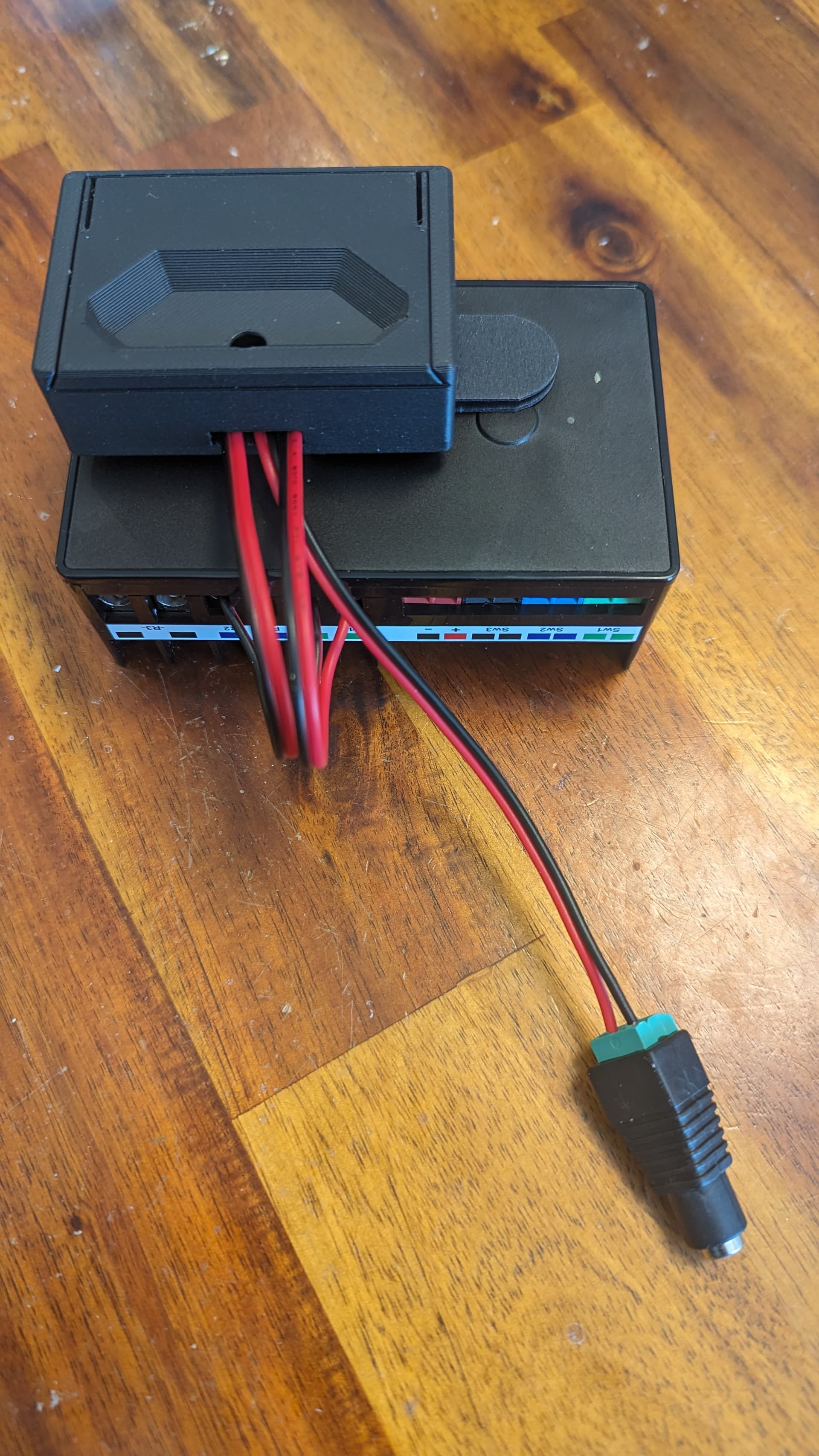

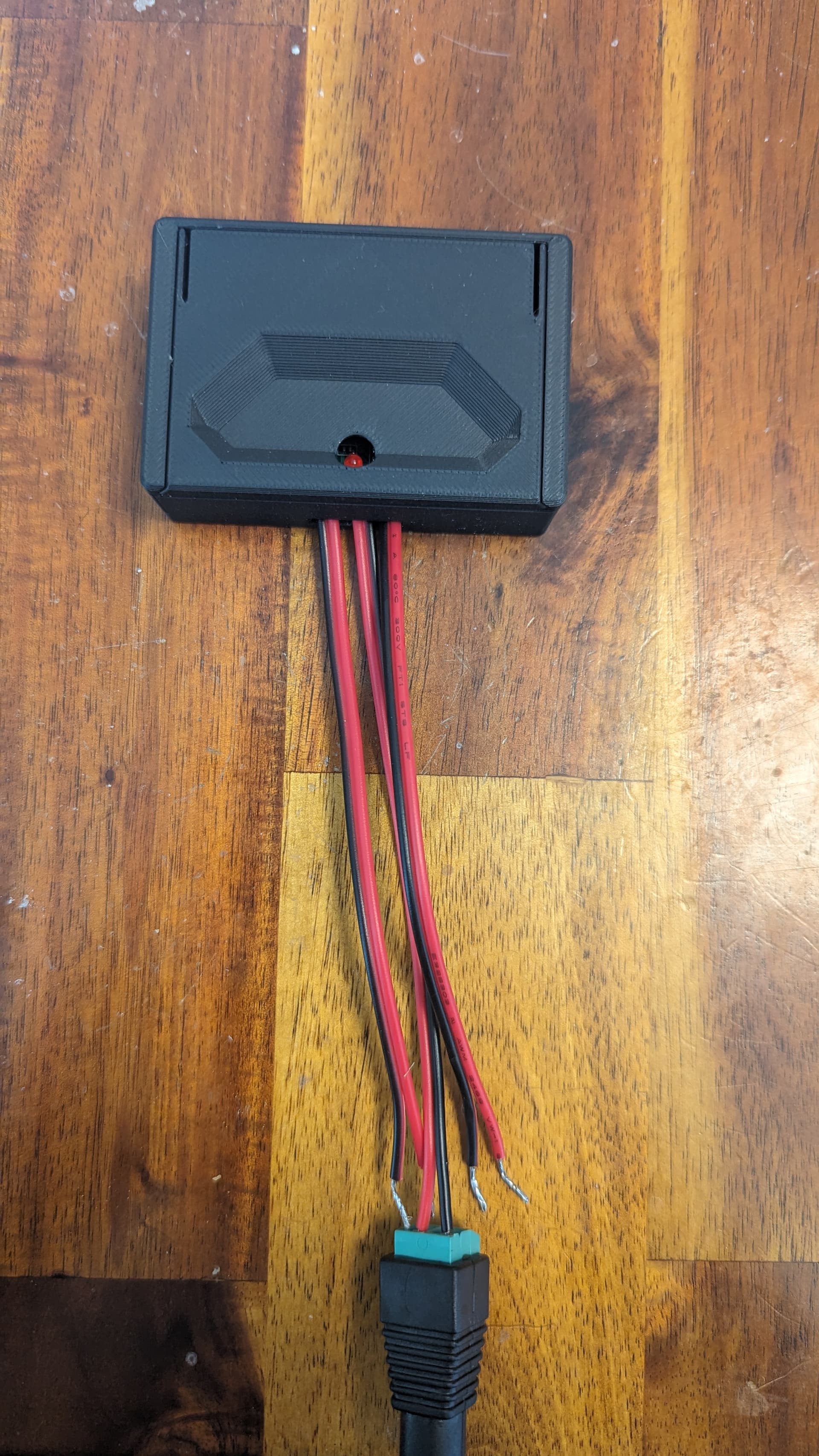

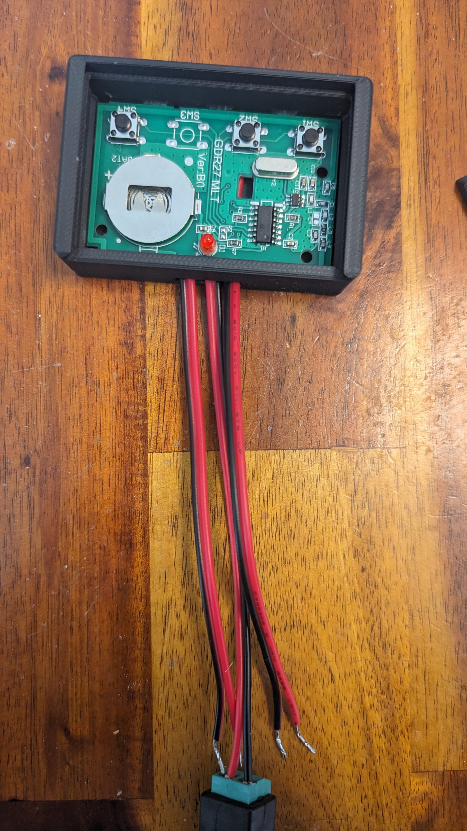

Just gotta say Thank You for this solution. I bought the generic version of the 893LM from Amazon (2pcs for $14.75) and a Zen16_v2, wired everything together, installed the apps, and everything works perfectly.
I wired the remote up to a 3V DC power source so I never have to change batteries. Designed and 3D printed a box that the remote PCB perfectly snaps into. Hung the setup on a closet wall out of the way.

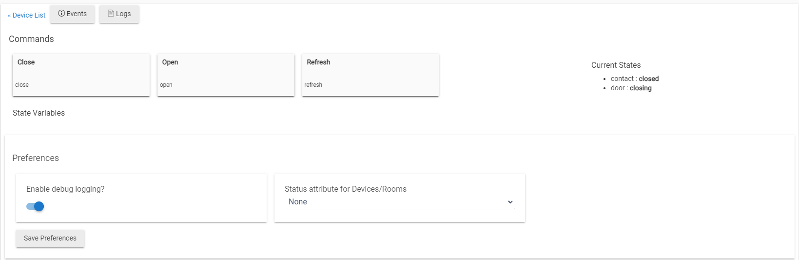

The current state of my garage door is stuck in "Closing." The sate of the contact correctly changes from open to closed but the door will not update. I tried rebooting the hub and clicking the refresh button, but neither help. Any suggestions on what I can do to get he door state to show the correct info?
Open and close the door.
I have tried that and it still did not update.
Go into the app and make sure your devices are selected correctly.
Turn on debug logging at the bottom.
Turn on all logging for the tilt sensor as well.
Then open and close the door, post the logs.
Did you open/close it using dumb button, or using the smart relay? Cycling the door via the smart relay (not dumb button) helps snap all my stuff back together when it occasionally gets out of sync.

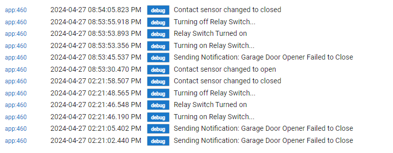

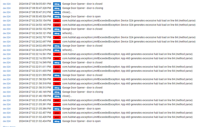

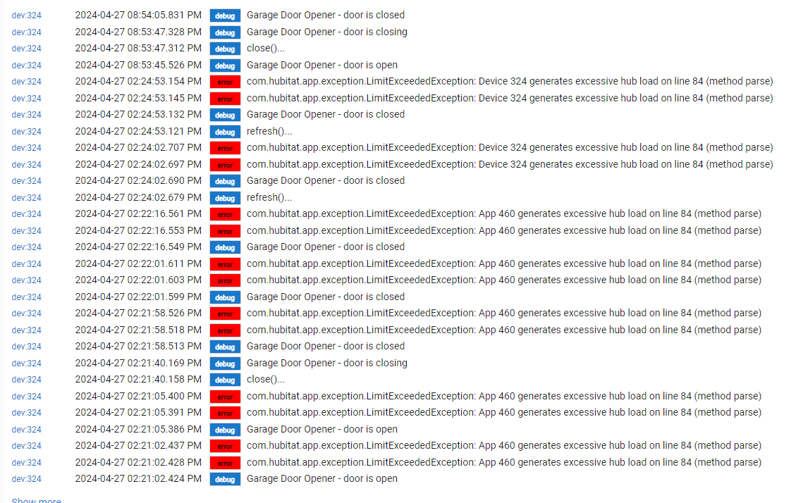

It has started working again, But it looks like I am getting an error in the app.
This is the log from the app:
This is the log from the Open close Sensor connected to the Zoon Zen17.
I am not sure of the brand of position sensor, but it is a wired one connected to a Zooz Zen17
You need to reboot your hub, something bad is going on. See if the errors go away after that.
I did not get any errors after the reboot. Thanks for your help
