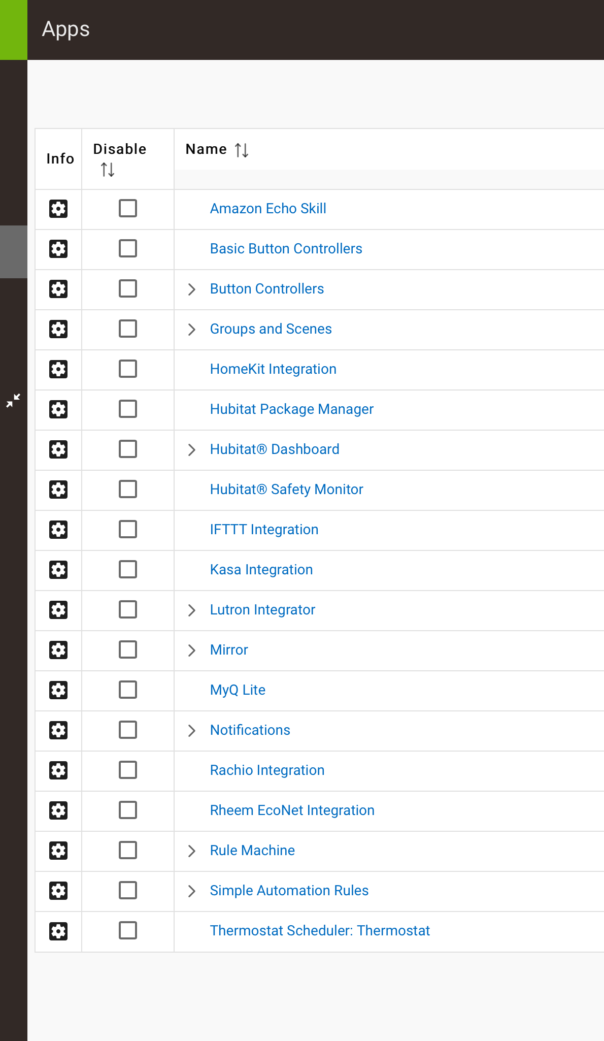

I've installed the app via the HPM but when I go back to my app screen I cannot locate the Wyze App...What am I missing?

Check and see if it us listed in the user apps [+user] button top right. Appears as though it did not install.

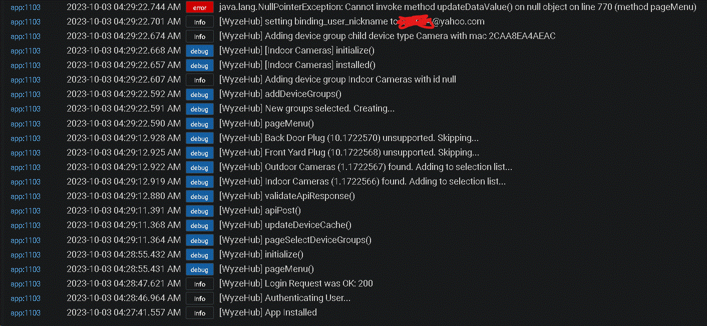

Here's a screenshot of my logs:
It shows "Indoor Cameras (1.1722566) found" but then "Adding device group Indoor Cameras with id null". The null id is the issue. For whatever reason, the id is disappearing after discovery.
Can you try adding only the outdoor group first and see if that works?
That worked! It installed both the indoor and outdoor groups and it's working when I set the motion recording to true and false. I appreciate your help!
