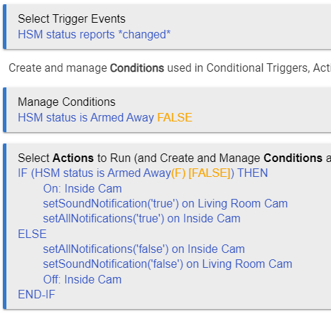

If you just want to turn on/off notifications but still record..then there is an option to change the motion notification (true/false).
Yes! Here's what I do when HSM is armed away:
