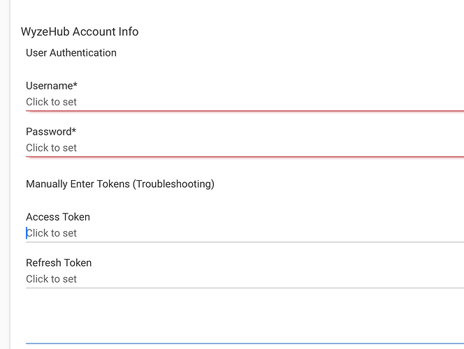

Here is a screenshot of my login screen.
Notes:
  • Copy and paste Key ID and API Key as presented on the wyze site (including dashes).
  • Leave the bottom two lines blank, those are intended for troubleshooting with a token that you have acquired from another source (i.e. Post-Man).

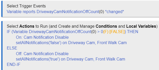

Well, my automations are not working reliably. I'm not getting errors in the log, but it looks like calls to the API aren't taking effect immediately. This was all working fine before the login change.
E.g., I have a variable that is incremented by any of several doors opening, and then decremented 3 minutes later. When the count is >0, I turn off all notifications on 2 cameras via invoking setAllNotifications(). I turn it back on when the count goes back to 0.
I have notifications on the cameras to tell me if someone is on the driveway or front walk. The intent of this rule is to stop those notifications for a few minutes when we open a door and leave (including the garage doors).
Since I got the API key version installed, I've still been getting notifications, e.g., when I go outside to pick up the newspaper.
But it works sometimes. It seems like the API is responding slowly or something.
Of course, when I tried to capture debug logs while opening a door, it worked correctly and the notifications were disabled timely.

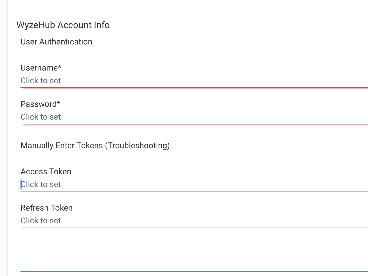

Hmm. Mine doesn't have the slots for KeyID and API Key in the top spots.

You need the updated app code. Replace the current code with the one i posted above.
I did. I even removed the old app and took the raw import url from your post. I must have grabbed the wrong one somehow. Can you give link to the groovy again?
Here is the direct link to the raw file
https://raw.githubusercontent.com/fieldsjm/Hubitat-2/master/WyzeHub/apps/wyzehub-app.groovy
Thanks! That got it!
