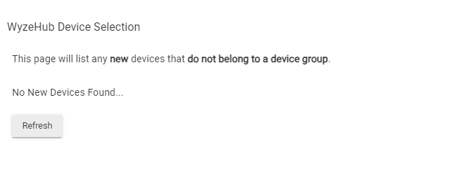

i am having the same issue. i deleted, uninstalled, re-installed and generated a new API key and added it but now it says i have no new devices. i can't even find the old ones anymore. please help.

Same issue here. Tried the updated code and put in the key an api key. No dice. When I go to device it just says "no new devices" . First time setup.

I believe it will say "no new devices" until you obtain authorization.
Did you get a login successful message after entering the key id, api key, email, and password on the configure login screen?
