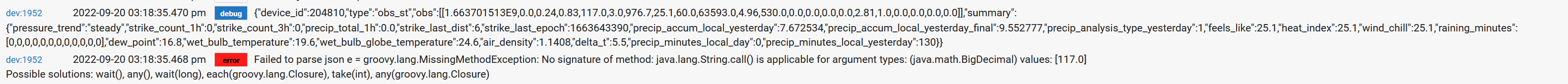

Debug logging should turn off after 30 mins, but message logging can remain on. You should be able to turn it on manually.
Thanks, what is message loging? I don't see an option
Ahh, thought it was in there. He only has debug logging turned on. Message logging is likely on but not controlled. @augoisms want to chime in here? As said though debug logging automatically turns off after 30 mins.
I sent a pull request to fix these
@augoisms @nh.schottfam I too am getting the same errors. (I am running beta hubitat though if that makes a diff)
Same here.
So is this with the released code or the pull request? I can look at it if it is the pull request.
Release. I can install the pull request and see how it does...
Just pushed an update with @nh.schottfam 's fixes and dewpoint addition. Thank you for the contribution!
@rlithgow1 @imbeta Debug logging is purposefully disabled after 30 minutes to reduce load on the system. There are no other settings for logging at this time.
